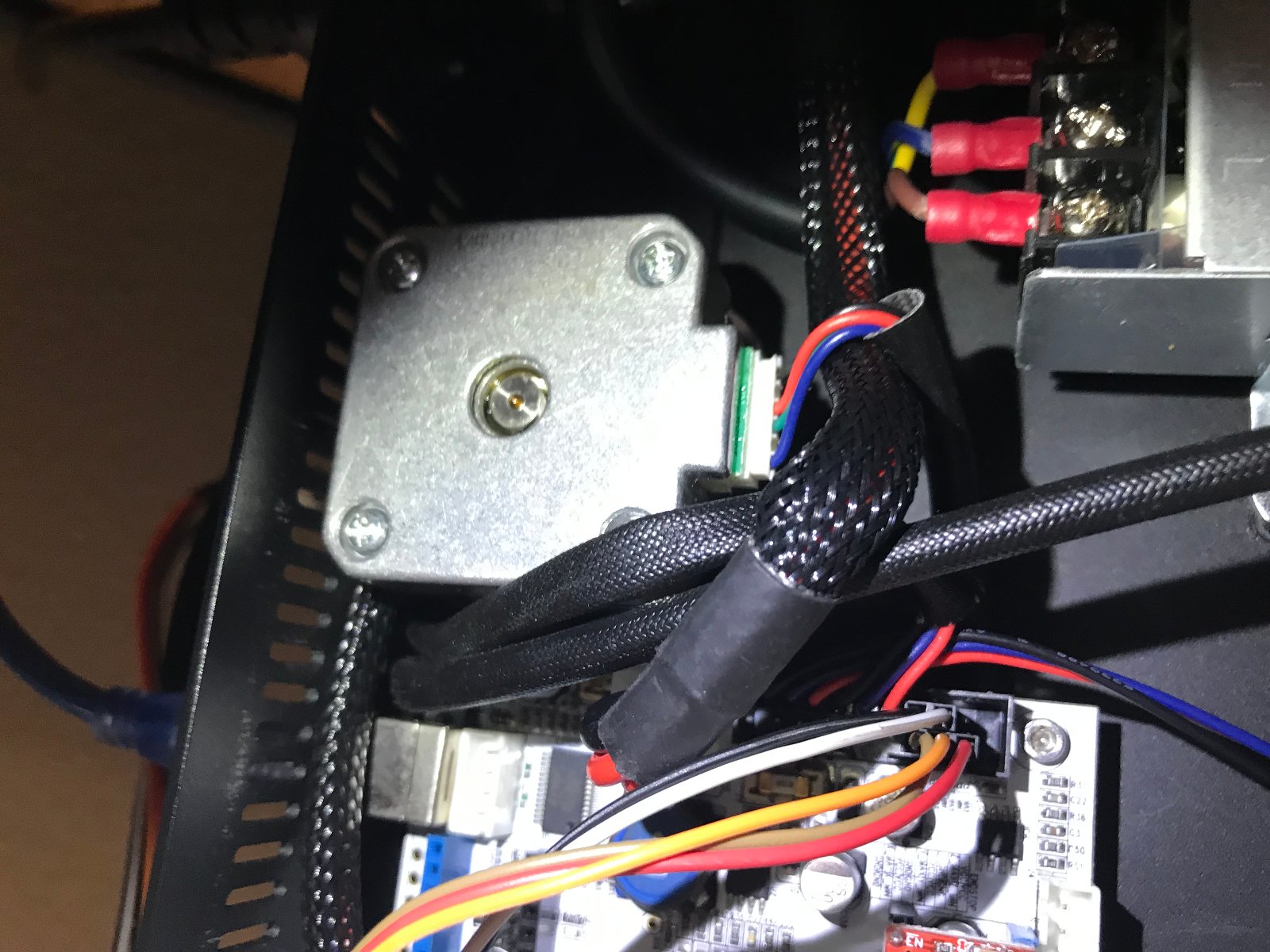

I have the BLtouch working for the Mecreator 2 w/ GT2560 Rev. B (Same board as A10)
Utilizing Vert's 355 firmware.
X_MIN_PIN 22
X_MAX_PIN 24
Y_MIN_PIN 26
Y_MAX_PIN 28
Z_MIN_PIN 32
Z_MAX_PIN 30
SERVO0_PIN 30
Please see pictures for pin connections.
I hope this helps.
