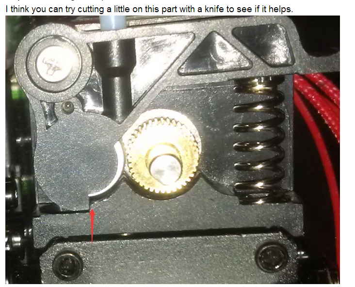

Posted: Thu Dec 01, 2016 10:35 am
by Jethro
My extruder is also not working, the stepper turns but there is not enough pressure on the filament to force it through the element. If I assist the extruder by hand (pushing it through during a print) it does go through, so it's not a blockage. There is no screw on top of the extruder to increase the pressure.
I have tried putting a small rubber band around the idler in there but it still can't get enough grip to extrude properly.
Is there a bigger brass drive wheel available? Or a new plastic body?
All other suggestions welcome, thanks!
Re: Extruder not working
Posted: Sat Dec 03, 2016 5:03 pm
by William
Hi,@Jethro
See this picture:
