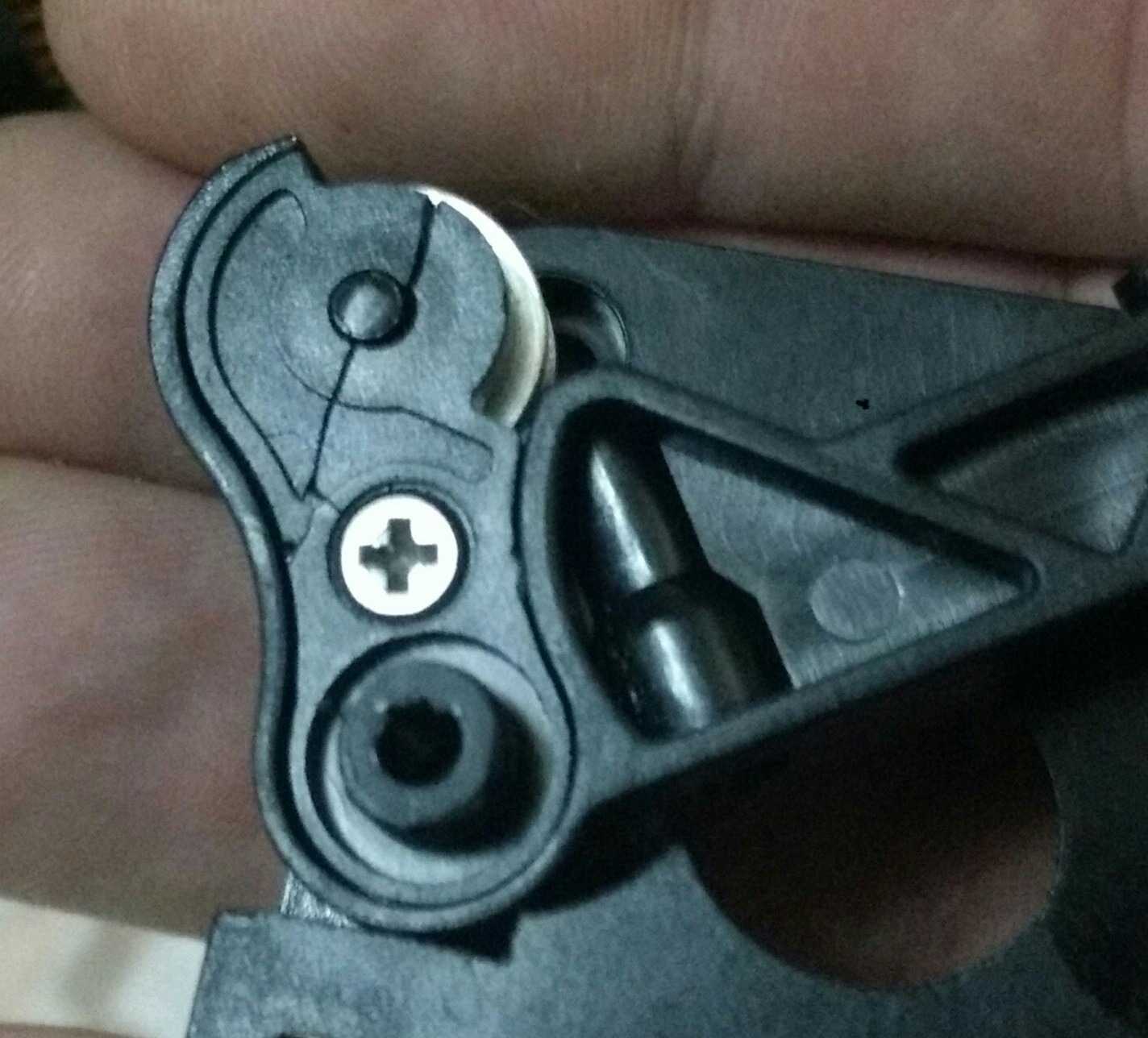

My brand new kit was suffering underextrusion issues which I tried to solve over about a week. Nothing helped. I read on the forums about the weak tension arm so i dissassembled the extruder to make some changes as mentioned in elsewhere in this forum but before I even made any change I finally uncovered the problem.
This part was hidden against the stepper and tension arm the whole time.
Geeetech please do all your future customers a favor, remove every plastic mk8 extruder from your kits and throw them in the bin where they belong. Please don't try to quick fix this with tougher springs, you just destroy the extruder. Just read the comments! You're making a grave mistake supplying these.
