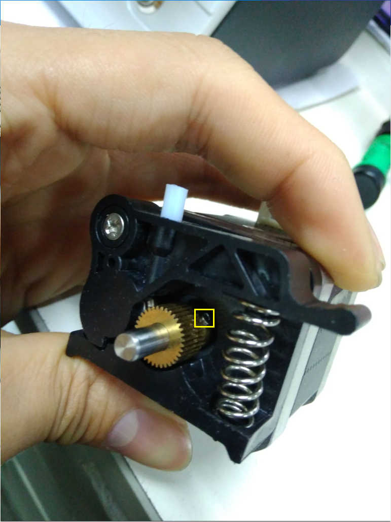

1.Check the nozzle it is colgged or not(If it colgged,you should clean it via Ejector pin)
2.You can increase the voltage of A4988(You can refer to this post:
viewtopic.php?f=19&t=17097)
3.Check the gears of the extruder were be firmly fixed

Well.It seems the issue root is the motor
