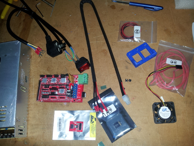

Can you also supply the wiring diagram for the parts pictured here:
Mains Power supply cable and switch
Mains Power supply unit
Fan is for?
#49 and #50 go where?

The blue part in your picture is used to attach the fan for cooling the mainboard and firm it to the aluminium board .

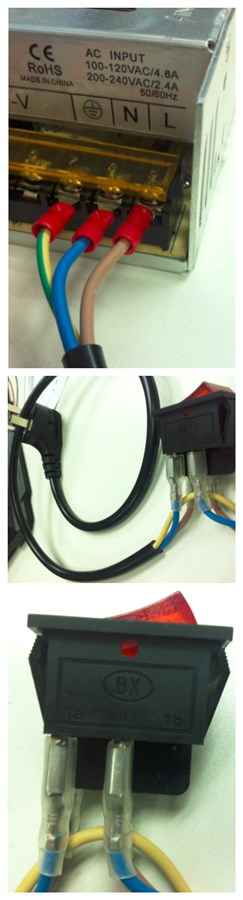

Power supply cable(2 black wires and 2 red wires):Cut the white plasic head first. The red wires are connected to the positive pole, and black wires are connected to negative pole(you don't have to distinguish 5A or 11A).
Power supply unit(which includes 1 yellow wire):The yellow wire is connected to GND. On the switch, There are 2 groups of hole for N and L. Contect 2 red wires on one side and 2 blue wires on the other side.
There is a picture for reference below.
#49 is for connecting thermistor on heated bed to the mainboard.
#50 is for is used for testing the temperature on the
Fan is for cooling the mainboard. (red for "+",and black for"-").
You'd better connect the 2 fans to the 5A interface.(red for"+", and black for "-"). Before connecting , you have to cut one side of Dupont line to connect them to the green interface(recommend 5A).

Sorry I need a diagram as the voltage is high it will not make sense to risk a mistake.
Your photo does not seem to be of this kit and I can't follow your power wiring. Plus there is only 1 x fan. It does not fit on Fan bracket and fan bracket dos not fit on kit.

Oh, I am so sorry. Because I am a new guy, I thought there are 2 fans for Aluminium version ,as same as Acrylic version. Indeed, there is only 1 fan for cooling mainboard for Aluminium Prusa I3.
The power wiring is shown in the picture.And I will leave a picture which shows how to fix the fan in the next reply.

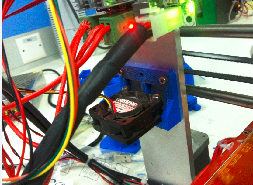

Here is the picture which shows how to fix the cooling fan.
Note, red wire is connected to "+", and black is to "-"pole. Ignore the yellow wire. you'd better cut the black head so that you can connect them to the green part on the mainboard.
