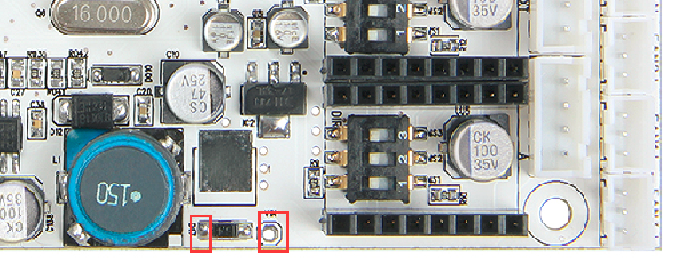

Please test the voltage between "D17" and "GND", "Vin" and "GND" seperately. "D17" and "Vin" have been highlighted in the picture.
The power of fans comes from D17.
