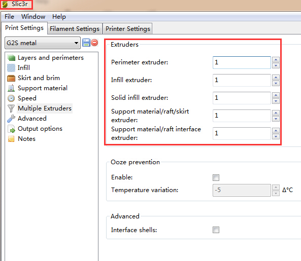

" how hard is it to print on extruder 2 by default"
you can choose the extruder you want to use in the slic3r.
