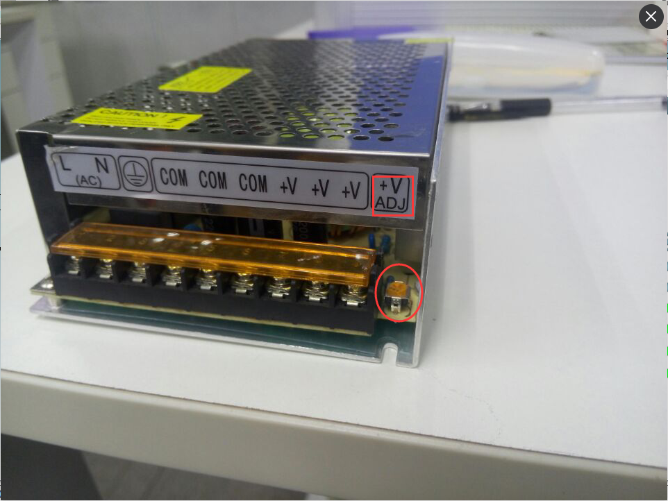

Torm, can you please explame me how rise you heatbed voltage to 13,6V??
I get only 10,7V on my headbet...
Re: I3X Acrylic 8mm /GT2560 hotbed wrong temperature measure
Posted: Tue Aug 23, 2016 5:43 pm
by William
You can test the DC output(around 12V) of the PSU,you can adjust the potentiometer if the output is not sufficient:
- 0..png (472.72 KiB) Viewed 14026 times
