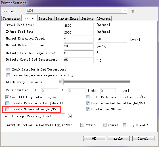

1- when prepearing for printing or during a print, the motors of the XYZ axis let the spider with 2 extruder fall on the printed object. adding the G29 command can't help solve this problem

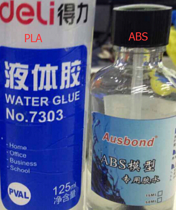

you said glue.. which kind of glue?

hi again mark, i have tested the "M84 S0" command,
still not resolve my problem. after homing the printer, it fells, slower than last time, but fells down again.

2) the glue, you can check the picture below. And all the normal glue for PLA or ABS models will do.
3) the motor, don't select the settings here:

the command to kill motor has been removed, will try it in next print. will let you know
for the glue, i have some difficulties finding it, maybe on internet or is a random "water base glue" ?
