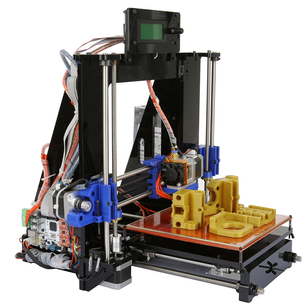

This is the type of printer I have:
- i3.jpg (234.13 KiB) Viewed 18653 times

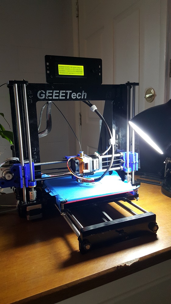

This is my i3.
- My i3.jpg (202.01 KiB) Viewed 18615 times

It was working great then suddenly began intermittently jamming. Running PLA with the extruder at 220. I started at 210 and kicked it up to 220 in the hope that was the issue but it isn't. I adjust the tensioning bolt very slowly but it does not seem to resolve the issue. If I place a little bit of pressure on the metal tab sticking out of the front of the extruder, no clue what it's called, then it runs fine so it tells me it's a tension issue.
Re: Mk8 Extruder adjustment
Posted: Sat Feb 20, 2016 9:13 pm
by jburke4
Looking closely at the tensioning screw and the design does not make a lot of sense to me. I see other extruders online and there is a solid bolt going all the way down through to the bottom of the frame, but mine is a bolt that only seems to push down on the top of the spring. There is a bolt coming in from the bottom of the extruder frame which seems to serve only the purpose of keeping the spring in place. There is a cap on the spring with threads going about 1/3 into the spring. When I screw the tensioning bold down it seems to press down on this cap, compressing the spring, but I can't see it doing anything else. Perhaps this is the way this model is supposed to work and there is something happening that I can't see.
Posted: Sat Feb 20, 2016 9:17 pm
by jburke4
Sorry, just trying to work this out in my head. It looks like the more you tighten the tensioning screw the more it is supposed to lift the lever device thereby placing pressure on the grooved wheel squeezing the filament against the gear. Unfortunately it seems that the lever on my extruder may be too tight, sticking, or something because when I adjust the bolt it keeps returning to it's original position on me. Should I lubricate this, try to loosen it or something?
