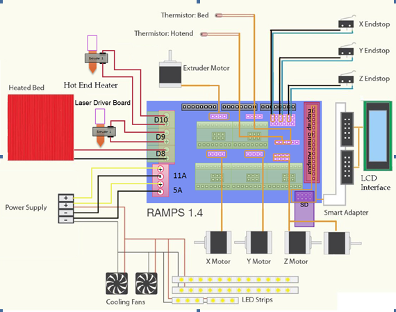

Re: Problem with heatbed
Connect them like this pic
- 1462497909442.png (180.44 KiB) Viewed 14103 times
Thanks, but which cables connect to 11A and which one to the 5V? Does it matter? (That why I asked earlier the current in each "group"...)William Kwok wrote:Connect them like this pic
