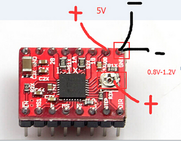

Hello,
I have Geetech 3d Mini desktop printer and sometimes the extruder has difficulties pulling the PLA, is it possible on this printer to add another pulling motor ?

ariel.ramraz@gmail.com wrote:Hello,
Maybe the driver module's(A4988) driver abilities is not enough.You can increase it by adjusting the potentiometer.Refer the pic below:

Thanks for the quick response, I'll try checking it out but not sure this is the issue, sometimes the material comes a bit tight on the wheel and then the printer has difficulties pulling it, I saw in different printers that they have additional motor that help pulling the material.

ariel.ramraz@gmail.com wrote:Hi,
thanks
Well,you can check it first and tell me what it goes on.Additionally,one motor is enough cuz it mainly matters the driver abilities.

HI!! I have the same problem! :( i read in some articles that i have to test the voltage (Vref) without the jumper, it is correct? and in this post i read that it is necessary shut off the printer when i am adjusting the potentiometer, is it true?...

AnimA wrote:HI!! I have the same problem! :( i read in some articles that i have to test the voltage (Vref) without the jumper, it is correct? and in this post i read that it is necessary shut off the printer when i am adjusting the potentiometer, it is true?..
It may not true,if you cut off the power of your printer,then how does the voltage come from?
