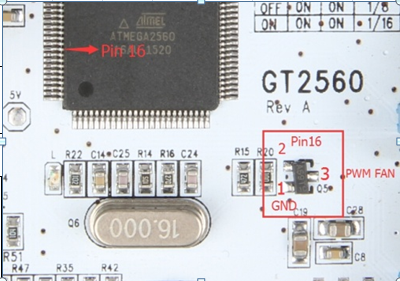

The PWM fan is controlled by the pin16 of the mainchip. When you turn on the fan, then the voltage between the pin3 and pin1 of the mosfet is 0V, and when off, it will be about 11-12V.

Does this apply to revB though as well? I ask because the image you post is to revA and configuring pin16 as the ppm fan pin does not seem to allow the fan to turn on or off, tested with a volt meter, scope and a physical fan.
This is why I asked if a schematic were available so that I could check the pins assignment in there for both the LED strip and the PWM fan and correct the pin assignments in the firmware.
Thanks
Sorry,i don't have a schematic of GT2560 Rev B.But i learn something about it from our engineer,pin16\pin17\pin18 are controlling the PWM fans,and he didn't tell me what the exact pin is.I'm sorry you have to try it one by one...

Pin 16 = LCD_PINS_D4
Pin 17 = LCD_PINS_ENABLE
Pin 18 = BEEPER
So none of the pins mentioned, if the firmware is correct, are the fan pins. To be honest, if Geeetech can't fix the firmware and we are unable to get a schematic to fix it ourselves then this printer is essentially not worth it. It is basically completely closed and unrepairable in my opinion. (or cannot be modified by owner)
