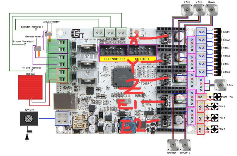

Ok, I think I figured out where the issue is coming from. I swapped cables from one motor to another, no change. I swapped motors from one side to another, it stayed on that channel. I swapped motor on channels, and it moved to which ever motor I have plugged into that axis port, to which I found out is actually the Y axis port (which I messed up because I have found I had received conflicting instructions... the one that came with the kit differed from the online and since I was bouncing back and forth between the two.. looks like I got punked). I've also swapped the driver boards around and there hasn't been a change. What ever is plugged into the Y axis will puke when trying to move.
So, does anyone have an accurate diagram of what axis is which on this God Forsaken printer? Where can I find what driver board actually goes to which channel? So I can at least make sure it is indeed wired up correctly and second does anyone have any idea what might be going on besides a possible bad board. I am beyond disgruntle at this point with this printer. I am slightly miffed.
Re: G2s pro Z axis motor
Hi,here are some tips:platypusdr wrote:Ok, I think I figured out where the issue is coming from. I swapped cables from one motor to another, no change. I swapped motors from one side to another, it stayed on that channel. I swapped motor on channels, and it moved to which ever motor I have plugged into that axis port, to which I found out is actually the Y axis port (which I messed up because I have found I had received conflicting instructions... the one that came with the kit differed from the online and since I was bouncing back and forth between the two.. looks like I got punked). I've also swapped the driver boards around and there hasn't been a change. What ever is plugged into the Y axis will puke when trying to move.

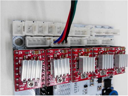

I don't entirely understand what you exactly mean,i guess you wanna know which A4988 controls what motor?If so,look the pic i attached: 4.You'd better swap the driver of the problem motor with other axis,take note of the A4988's direvtion when you're plugging it,the board will burn out if A4988 has a wrong direction,a right direction should be this:Where can I find what driver board actually goes to which channel?
