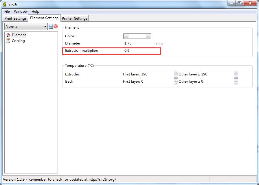

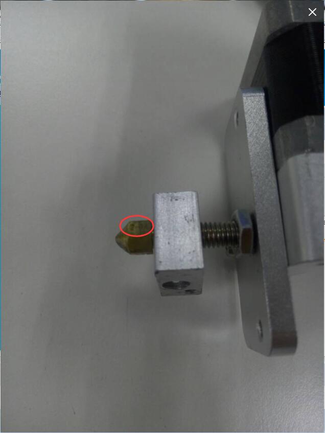

Hi,Andy
1.I think you can find the nozzle size in your order info or you can find it directly from your nozzle:
2.About the flowing rate,you can increase this value to 1-1.1 in your slicer settings:
