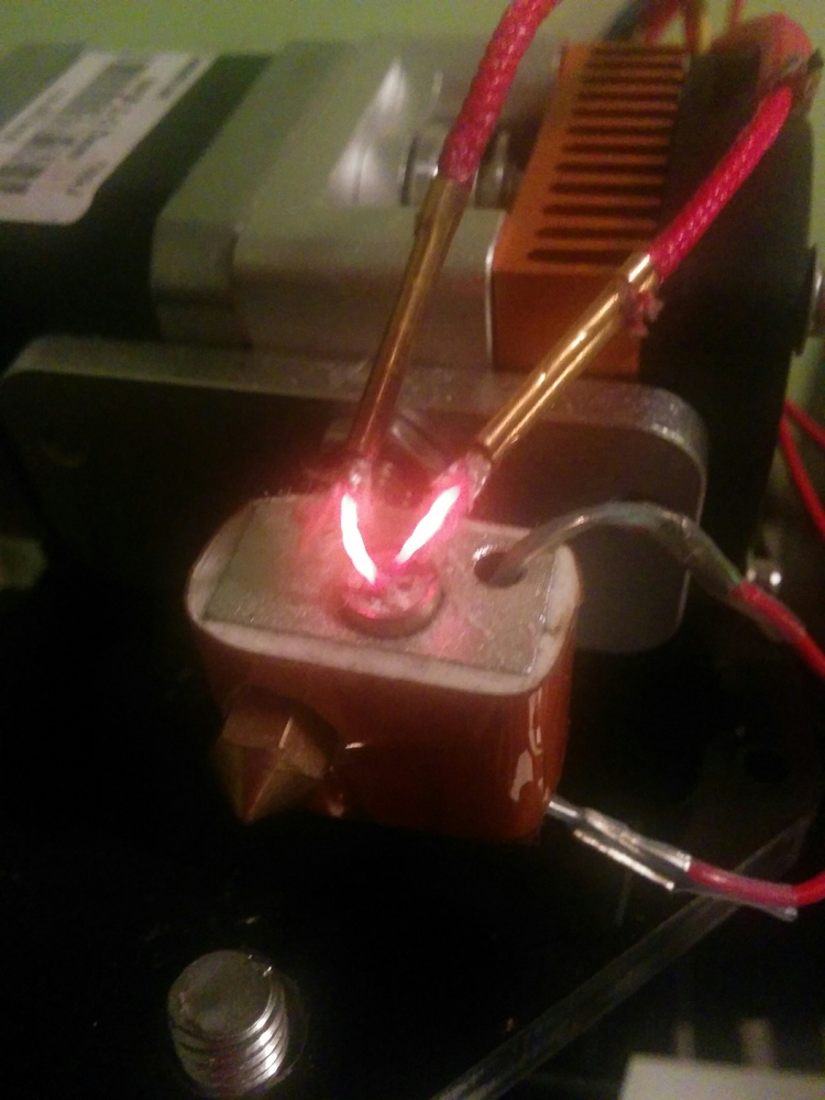

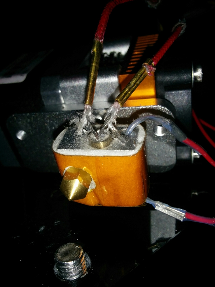

I have replaced the 10A fuse with a working one and tried it again, but it blew it again. I have an image on how red the wires for the heating element get before it blows, I have also followed this
http://www.geeetech.com/forum/viewtopic ... 19&t=17039 and the LED for the heating element turns on which means the MOSFET is good.
The following image is before I start the heating of the extruder
- Before heating
- extruder (1).jpg (323.58 KiB) Viewed 11213 times
The following image is how hot it gets in a few seconds before the fuse blows
- hot before it blows the fuse
- extruder-3 (1).jpg (408.46 KiB) Viewed 11213 times

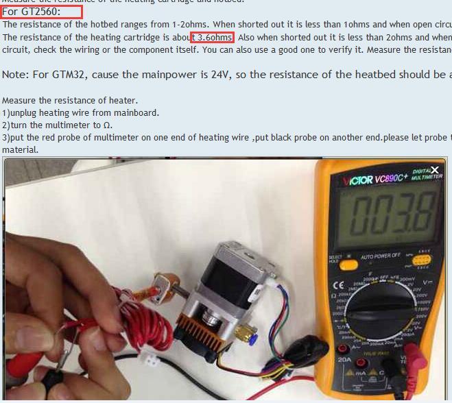

OK,sounds like the mosfet is good,have you measured the resistance of the heater,i guess the value is abnormal and has a overhigh power.
- QQ截图20160825101911.jpg (63.48 KiB) Viewed 11197 times
Re: Heating element is causing the 10A fuse to blow
Posted: Thu Aug 25, 2016 2:05 pm
by jaap
I measured it, and got 2.1 ohms, the way I measured it was I took the two wires of the heating element and made sure they were only connected to the probes of the multimeter and nothing else. I am kind of confused on what it means by testing when shorted it should be less than 2 ohms and when open circuit it is infinite? How exactly do I test that?

jaap wrote:I measured it, and got 2.1 ohms, the way I measured it was I took the two wires of the heating element and made sure they were only connected to the probes of the multimeter and nothing else. I am kind of confused on what it means by testing when shorted it should be less than 2 ohms and when open circuit it is infinite? How exactly do I test that?
I'm afraid you have to change a heater now...
