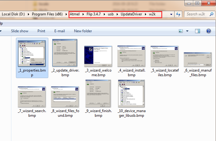

printboard driver update.png (88.31 KiB) Viewed 5834 times
You can update the driver according to the info there.
