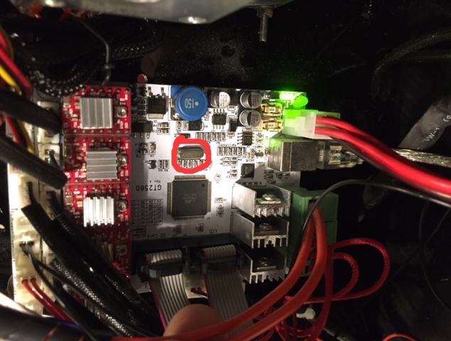

And can the board be detected by computer?What errors appeared in Arduino?Attach some photos plz.
PS.You can measure the voltage between the pin on two sides(see the picture) and GND separately with a multimeter,and tell the value.

Posted: Sat Oct 15, 2016 4:24 pm
by William
Re: Black boxes in LCD screen (prusa i3 Pro-C)
Posted: Sat Oct 15, 2016 5:22 pm
by Pate
Tried it but it didnt work either
Posted: Sat Oct 15, 2016 5:24 pm
by William
Then measure the voltage as i told to you when you have a multimeter.
