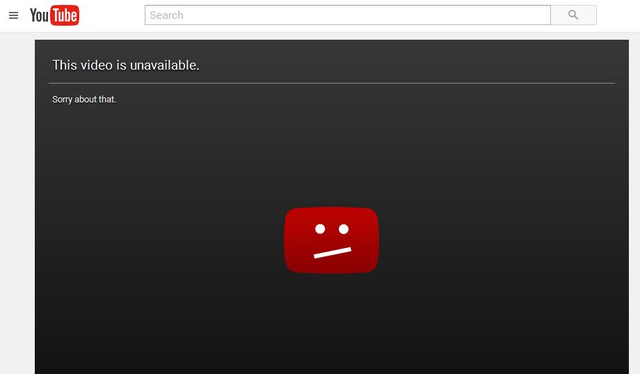

Been more than a little busy, but here https://youtu.be/dTFcrJKxy_0 is a video of the problem. The opening sequence shows the old board working. The middle section is my attempt at showing uploading to the sketch, and the final section shows the new board still not working .
Thanks
Cup
Posts: 123
Joined: Fri Jul 15, 2016 6:11 pm
Re: No LCD Light
Post by Cup »
Unfortunately,it is not available...
clariongrade
Posts: 5
Joined: Mon Nov 21, 2016 5:20 am
Re: No LCD Light
Post by clariongrade »
Strange, I have just clicked the link and it came up no problem.
