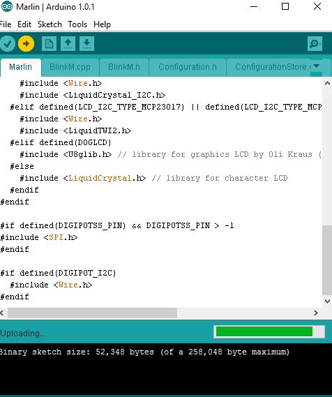

Freeze on Uploading.JPG (56.11 KiB) Viewed 12703 times
I've been attempting to upload the firmware a few times ... I get close ... but the Arduino seems to freeze before upload can complete ...
It stops at just before completion as shown below ...
This is for the "Full Aluminum Frame I3 Prusa Reprap 3D Printer"

DavidP wrote:
How's it going?
Keep uploading all the time and no more information?
Re: First Start Up Wiring Problems ??
Posted: Fri Dec 30, 2016 11:53 am
by DavidP
It finally changed to 'Done Uploading' ... I thought for a moment I finally had it right ... BUT ...
A long list of 'timeout's down the page ... ending with 'timeout communicating with programmer' ... the ending with 'failed miserably to execute command 0x11' & 'failed to leave programming mode'
I've got a direct connection between the computer and printer ... with nothing else tied in ...
