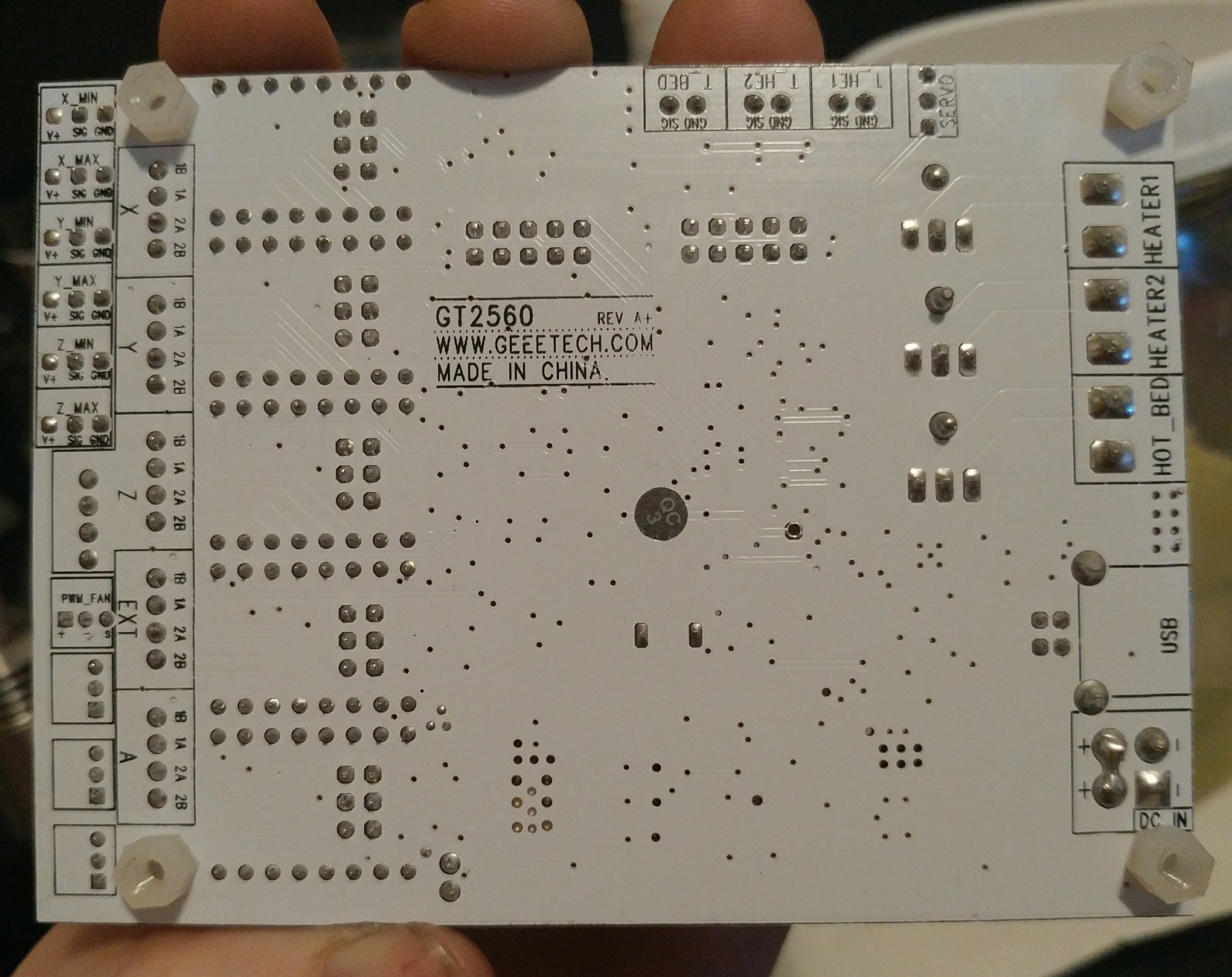

As to you extruder 2,could you post some pictures about the board especially including these ports you are talking about?then i can get it much better.

According to what you say, it's likely that the mainboard has some problem, could you take some photos about the motherboard,especially the connection part of the extruder 2 behind the board?

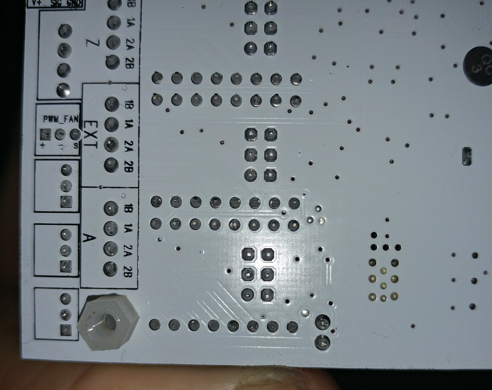

The port I'm referring to is labeled A on the back of the board. 1 solder joint is only half soldered but the rest look fine.
Re: I3 pro C problems
Yes,that is the key,you need to solder the half one to get it work.

I fixed to solder. I also reloaded firmware. Still nothing from the extruder. Now my axises are reversed so I'll have to fix that.
