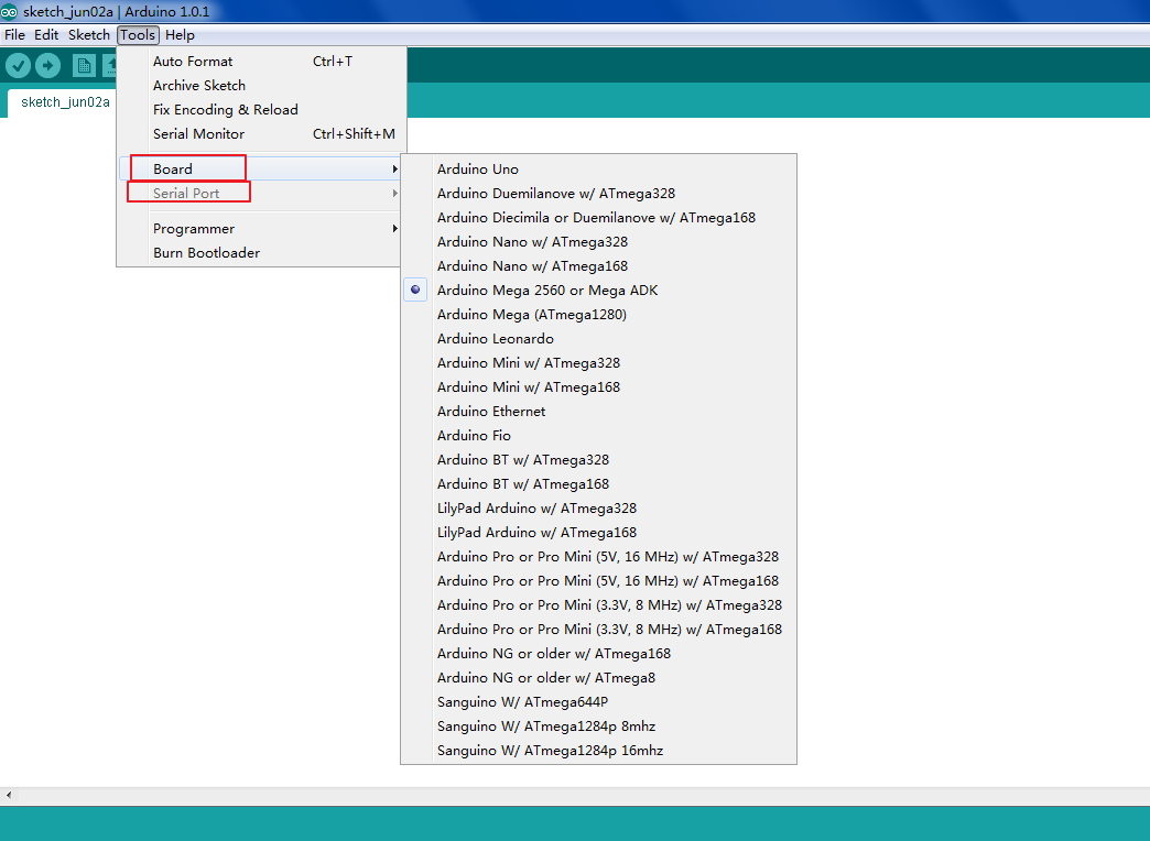

Hi,the firmware setting is correct.But I want to know which control board are you using? Have you choosen the correct Board and Serial Port in the Arduino 1.0.1? Please post some the pictures about it.

Yes, I have selected the board as you say and the port is correct.
