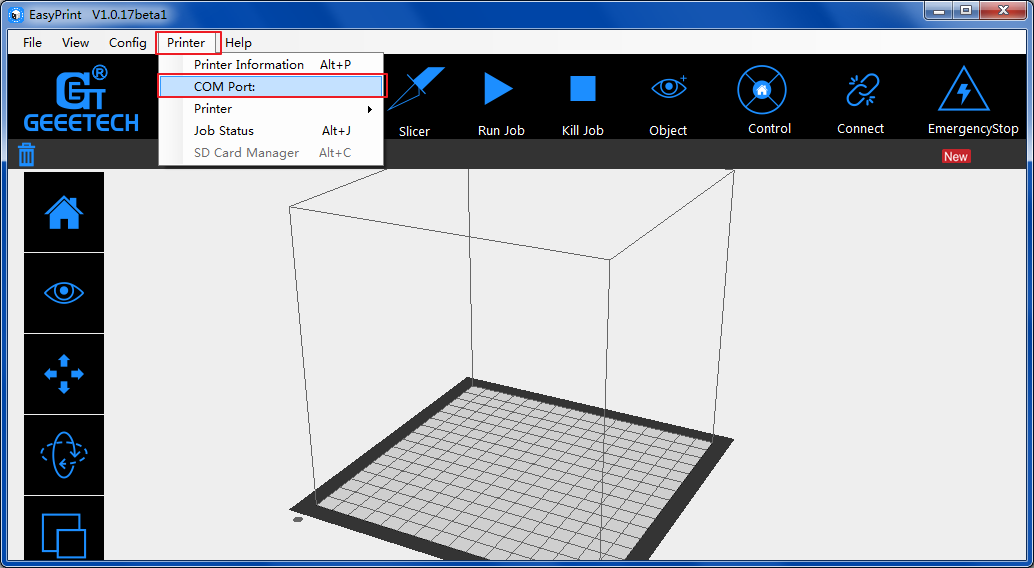

Hi,according to the error,It shows that your com port is wrong.Go to the Printer in EasyPrint 3D and select the correct com port,then it will be normal.
