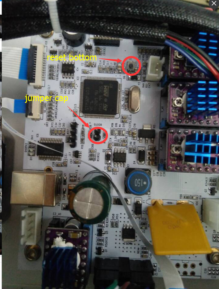

4. Insert one corresponding jumper cap on the boot0 of the board.
Connect the USB cable.

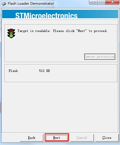

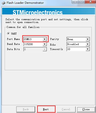

5.Open the Flash Loader Demo, confirm the COM port, for the rest do the setting as default. Click the Next.

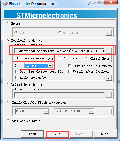

6.Choose the firmware"E180_APP_M_V1.11.11.bin" and check the "Erase necessary pag" radio and the address "8006000" and click Next to install it.

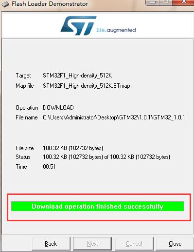

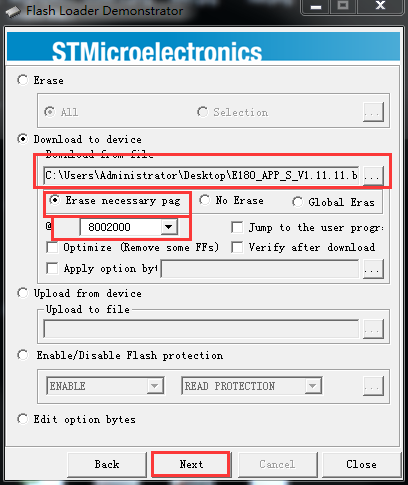

7.Then we start to burned the second file"E180_APP_S_V1.11.11.bin"
