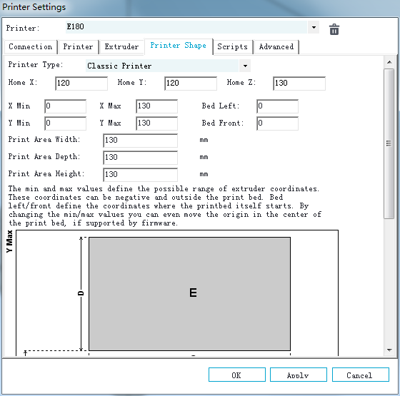

I use Repetier-Host for slicing mostly.It can be printed very well.
- E180.png (32.42 KiB) Viewed 16733 times

Hi William,
Can you post screenshots of the rest of your settings? I have a Mac and thus can't even load the EasyPrint 3D software, so I'm using Cura. Also open to using Repetier-Host if need be.

Personal Cura profiles for E180 have been uploaded to the forum, you can download
