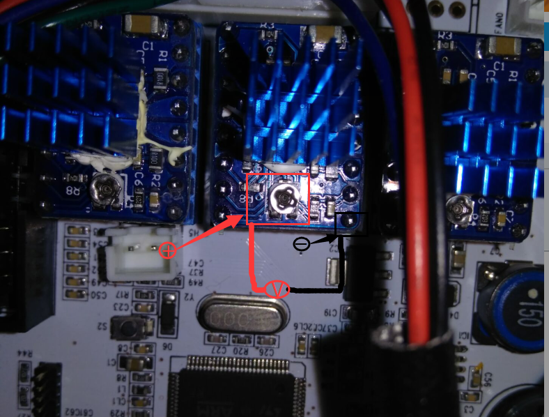

Maybe you should properly increase the A4988 driver board voltage(Normal is 0.8-1.1V)

I cracked open the bottom and noticed the Z_A1, Y_A1, X_A1 clustered together. The E2_A1 is separate and I assume needs tweaking. I am disappointed that this isn't a function via firmware or even Gcode.

The stock voltage I have on the E2_A1 was 0.46v and when I increased the voltage it made no difference to the extrusion length, it does appear to have increased the speed, but not the steps/mm. Additionally, when I increased the voltage to 0.93v the motor started to make a tick sound and jitter.
Therefore, reduced it back to 0.46v.
