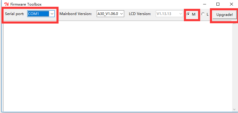

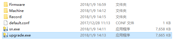

Hi,guys!
Some people ask me how to downgrade the A30 firmware, and I'll share a link .You can download it.
Please note, if not necessary, please do not downgrade easily, new version fixed some problem
https://drive.google.com/open?id=1LIN6n ... p1J1aQbBDf
