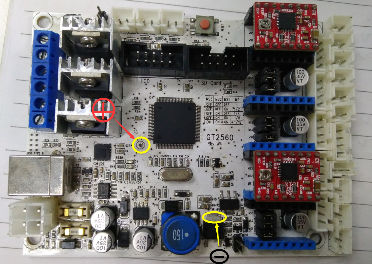

You can test the voltage of here(Normal is 3.8----5V) (USB cable supply power only)

Hey william i just did as you said and 0 Volts on the connection you've drawn in that picture so i guess the board is gone

The test performed indicates that the power supply on the controller board may not work or the input voltage does not reach it.
In the picture - the bottom left corner, you can see two identical elements in the sockets.
They are fuses. I would check if they are conducting tension.
Re: GT2560 A+ supposed to power up only via usb?
Posted: Fri Mar 02, 2018 1:34 am
by Producer_Phil
I checked the fuses, both are good. If i bridge the connection at F2 the board powers up and i can measure 5V but I'am still unable to upload sketches
