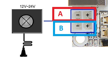

Hi, I am using a ATX PSU to power my 3D printer, I power direclty my two externals Mosfets from ATX PSU, one for heatbed and one for hotend.
QUESTION ; to power only logical part of the board, I am looking for to know wich side of the dual power feed I need to plug in... as show on my image... is it side A or side B ? Many thanks in advance.
[attachment=0]Power GT2560.JPG[/attachment]
- Power GT2560.JPG (33.35 KiB) Viewed 12880 times

If section A - has an electrical transition to section B - it does not matter. The rest (section A+ B+) is analogously.
However, it is important to connect a set of wires.

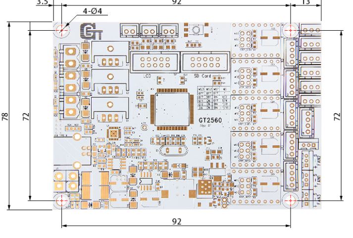

Here is the image from the back of the board.
[attachment=0]Capture.JPG[/attachment]
- Capture.JPG (80.65 KiB) Viewed 12790 times
Re: Gt2560 - plugin power supply for logical part only
Beautiful photography but it does not bring anything.
To check the connections, you can use a multimeter with the continuity test function.
You can also check the connections in the wiring diagram if you have one.

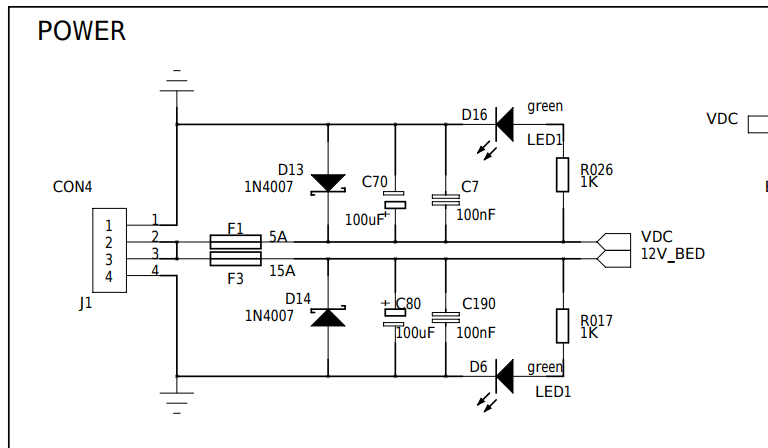

Bravo Gingko.
I love such hot details.
The diagram shows that it is impossible to separate the power supply as a colleague would like to do.
I place a clipping.
[attachment=0]wycinek_zasilanie_GT2560_vA+.png[/attachment]
Regardless of whether it connects the cable to the A+ or B+ pins, the whole controller is powered.
Therefore I would still use all the pins.
I place a clipping.
