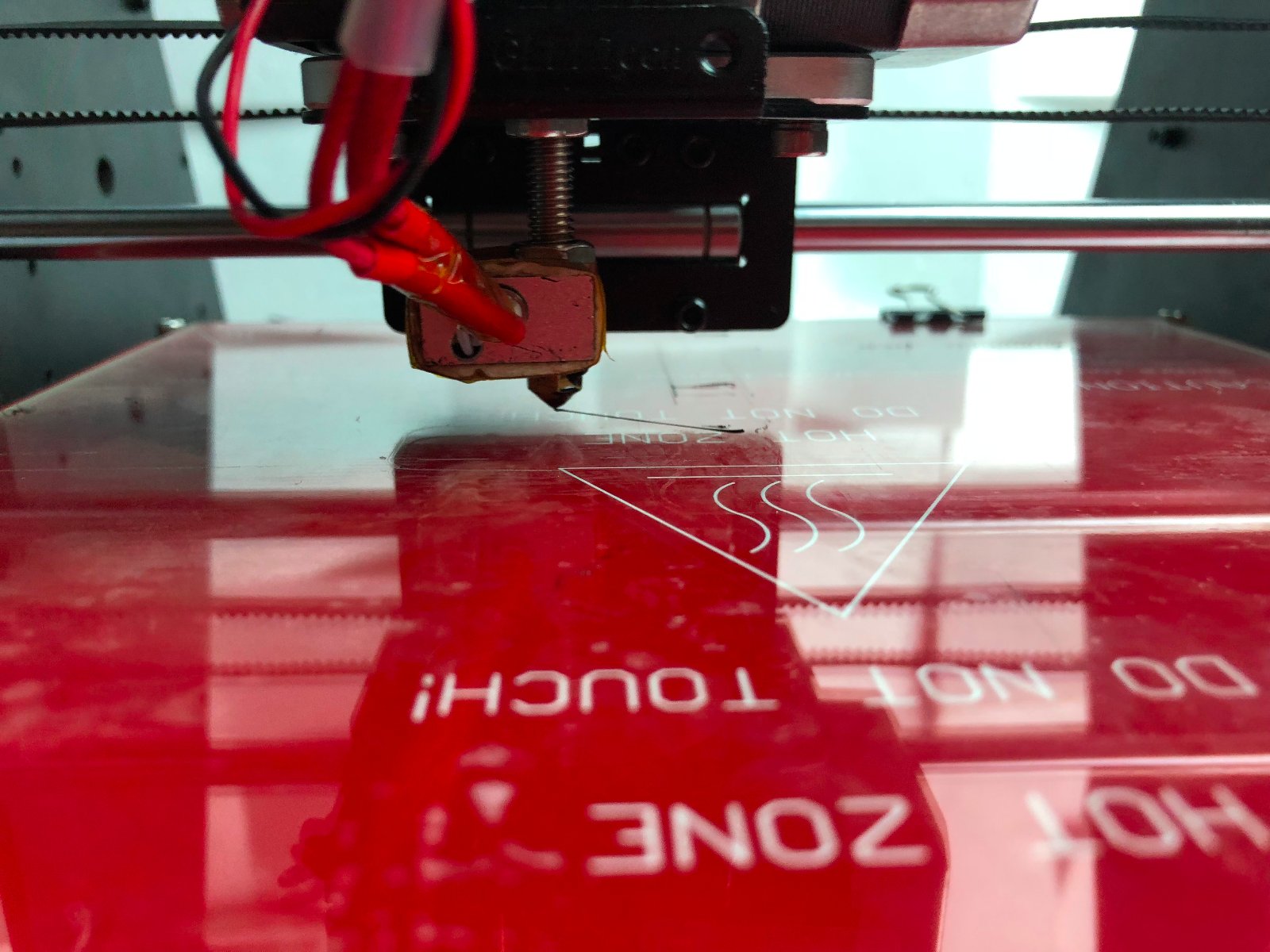

I have a newly purchased and assembled i3 Pro W, and am encountering issues with the Z axis.

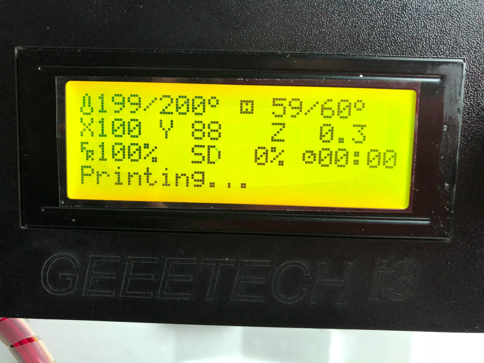

After I prepare and calibration z axis with bed and starting the printing, z axis take position higher than bed 0.3!! :roll: which affect the printing.
How i can solve that and make z axis good position during the printing?.
I need your advise :(

How did you calibrate the z axis?
Going by the pics, your first layer height is 0.3 but it looks like your nozzle is too high from the bed.

Actually i have did calibrate with piece of paper.. and when i set home, the nozzel be perfect level with bed. But the problem when starting printing it will start with 0.3! And that really big gaps between nozzle and bad :roll:

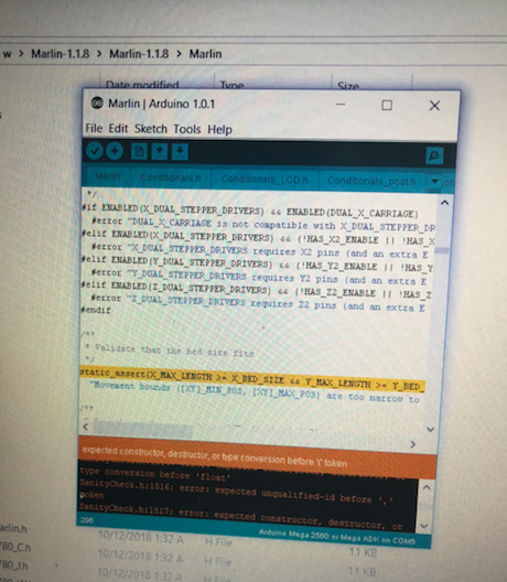

I have try upload marlin 1.1.8 but! get error!? :roll: :idea:

viewtopic.php?f=82&t=61011
Try this 1 that I got working on my pro w
Also update arduino version to upload or it dosnt work
