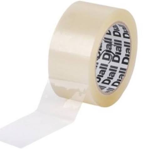

Re: Bed leveling: is my unit faulty?
Meanwhile I experimented on a hunch that masking tape solution can be improved even further. And the winner is combo of masking tape + clear packaging tape on top.
First layer sticks better (and at even lower temperatures than masking tape alone)
And based on my today's experiments I can say that with packaging tape on top there's no difference which masking tape to use. Even cheap white masking tape + packaging tape on top worked just fine
