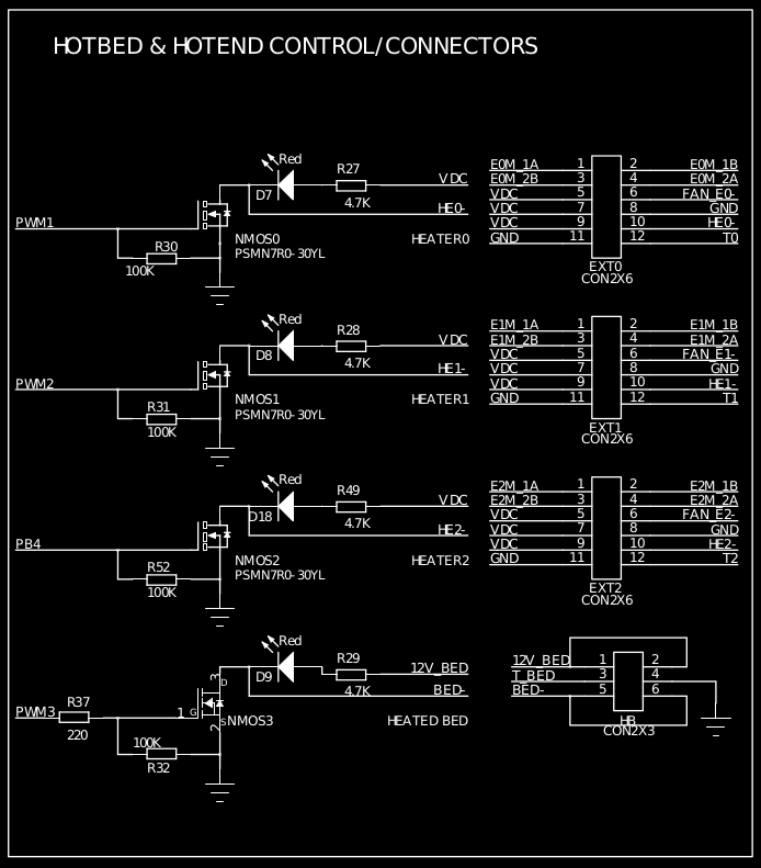

can someone provide me the pinout for the extruder-cable on a gt2560 v3.0?

I'm trying to fix my friend's a10 because it came improperly wired (it fried the thermistor sensor on the board).
to make sure I have this right.
T0 = thermistor 0
HE0- = heating element 0, negative
The layout seems odd because it does not match the expansion card pinout for the extruder.
on the expansion card 11 & 12 are the heater & 7/9 is the thermistor... why do the opposite ends of the extruder cable have different pinouts?

warbunnies wrote: Fri Jan 04, 2019 3:20 am ...
T0 = thermistor 0
We think the same in this regard. ;)
I am not able to answer these doubts. :roll:
