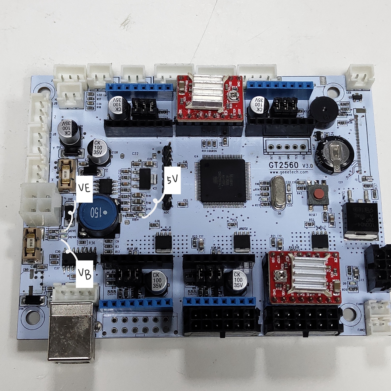

Hi, You can check if the three lights on your motherboard are on.
V3 三灯亮起的位置.jpg (1.51 MiB) Viewed 7984 times
If not, there may be a problem with the motherboard.
If the normal three lights on the motherboard are on,
you can provide specific problem pictures of your problem.
