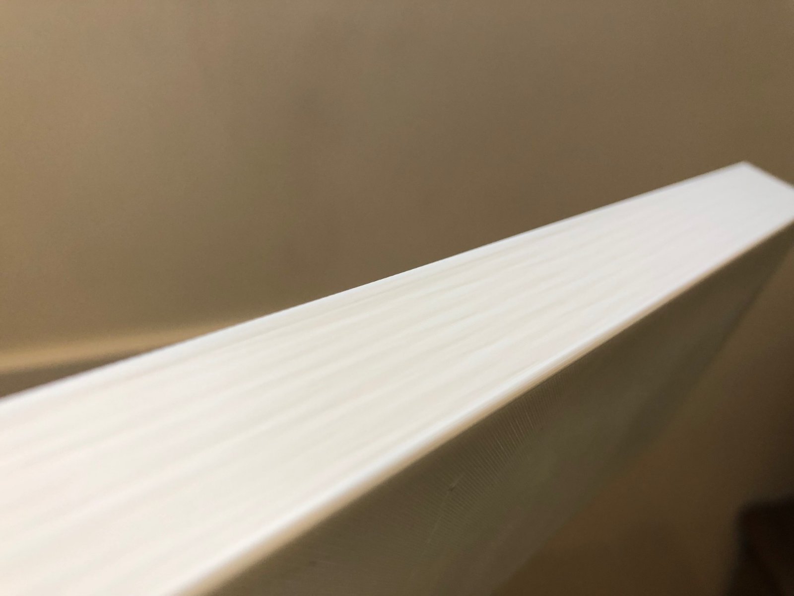

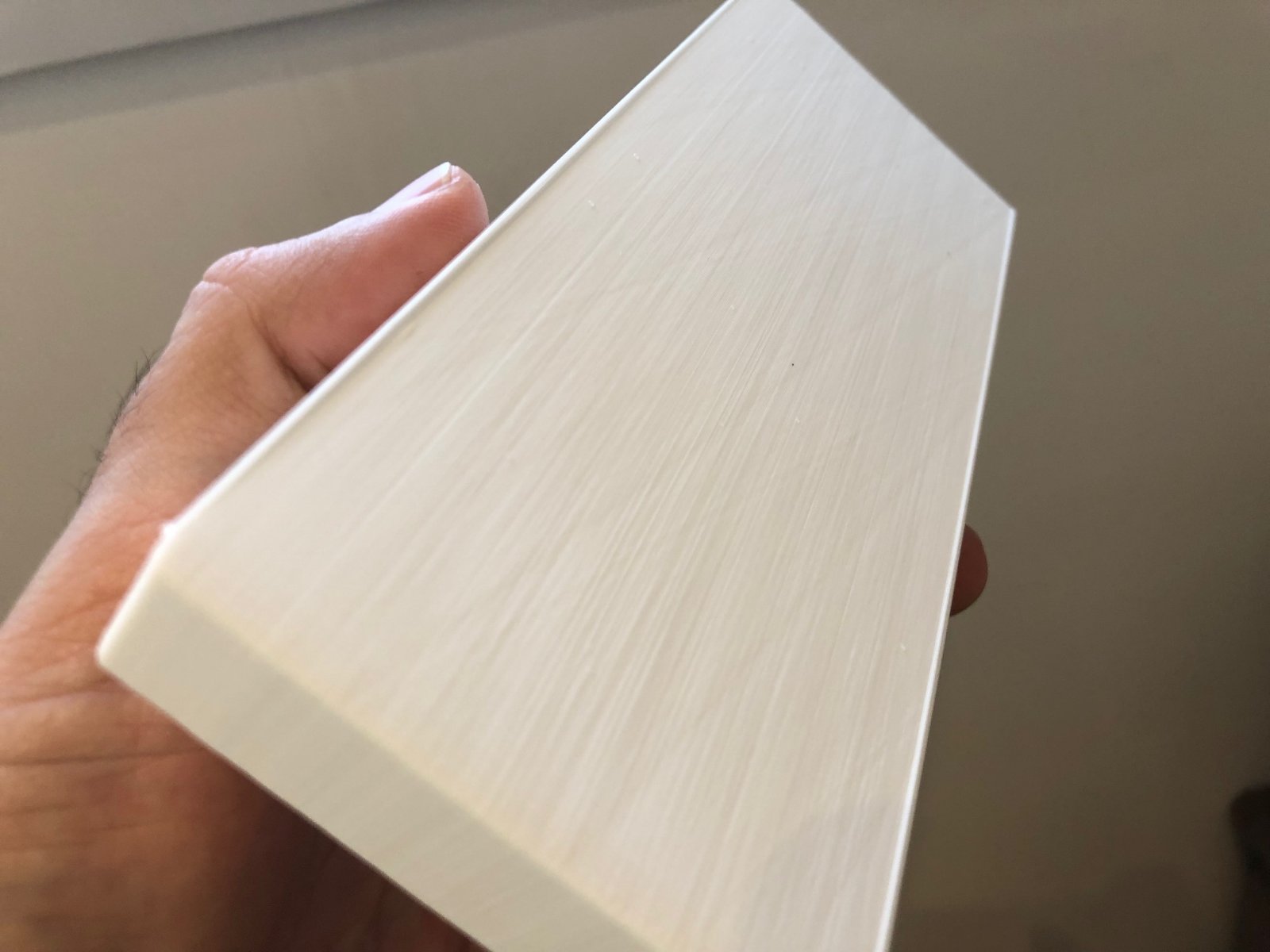

Hello, I have spending months trying to calibrate my A10M but fine tuning seems to be impossible, now the big problem is the vertical surfaces with horizontal and diagonal lines, I have tried: Change temperature, fan speed, extrusion multiplier, layer height and etc..
This problem is only visible when printing large parts, when I print a 20mm cube everything is fine or the cube is not big enough to see any issue.
Can anyone help-me to have a clue of what I have to do to improve the surface quality? Photos attached
Thanks a lot

Did you tried lowering the jerk values and printing speed ?
I have no experience with such large parts so I can't say for sure, but it may worth a try. Before I lowered jerk to 8 (default 20), all my printing were ruined because of bad y shifting. For a large part I would even lower it to 0 with a quite low speed if I would want a almost perfect surface.

Geeeko wrote: Tue Feb 12, 2019 6:55 am Did you tried lowering the jerk values and printing speed ?
I'm going to try, Thanks!!
