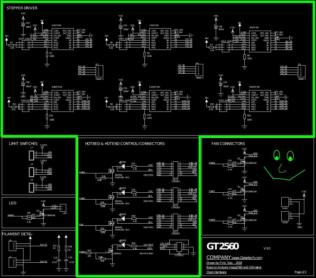

Hi everybody. Someone knows if is possible to adapt this hotend on a A10?

it would probably depend on your main board. (may be post a few more details?)
If you have 2350 v3 board, similar to the one for A10M, then they should have stepper driver ports separate and up to 3. so you probably will have to solder a few headers to incorporate all three on the board. if not, then maybe getting a new board with 3 drivers will be useful.

I'm looking for update my A10. The board is 2560 vers. 3. I think ther isn't third slot for extruder, so probably isn't possible to do a RGB hotend. I've also thinking to do a differtly approce; if is possible, to take the pins of one of the two extruders slots, and use it with shift register. I realy don't know if is possible, but.....

I suggest to take a look at the circuit scheme of the controller board. :D
I marked an area from which it follows that the equipment has been prepared universally, and it is possible to implement such a scenario.
In your considerations, you must also consider the capabilities of the firmware and the power supply you own.

As I'm away from home, the board have just a third driver for E2 motor or I need to buy it? Do you think is possible to customize A10 or A10M with tri channel hotend? Which changeing is needed for the hotend attach?

You have to buy an additional stepstick module in your area. :roll:
But pay attention to what I wrote earlier ...
And remember that modifying parts of equipment is not everything. :roll:
The topic you have raised is very interesting, and I think that theoretically it should be possible to implement. ;)
Being in your place I would start by finding the right firmware version.
Then you would have to find a triple hot-end and develop a handle.
Buy the necessary extruders, come up with a mounting ...
