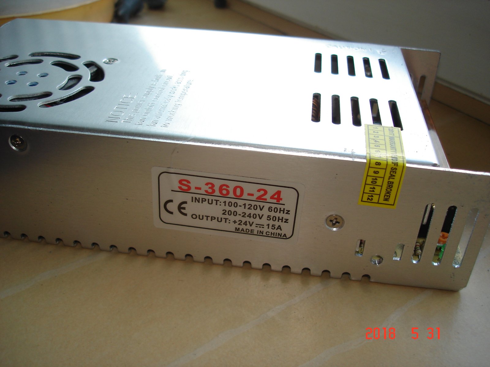

Akuma wrote: Tue Feb 26, 2019 4:39 am I'm wondering if 15a 24v is enough. It's only 360W which is under what my PC is.
Have you not made a mistake? Are you surely 24V?
My printer has a 15A 24V DC power supply.
Re: A10M keeps dying mid print!
Posted: Wed Feb 27, 2019 3:55 am
by Akuma
That's exactly what I wrote: 15a 24v :?
24x15 = 360w
