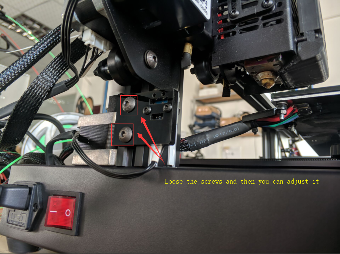

Maybe you can refer to it and adjust this part.
A20M-endstop kit.png (1.61 MiB) Viewed 7275 times

I somehow got it working the hard way, I used the 1.1.9 version (aarli version hex) and got somehow around the issue by very carefully leveling out the bed using a constant Z. Then stopping the steppers and started in the middle moving the head around to the edges successively until I adjusted the bed as good as possible, so I guess I did quite good, I made another run with the 9-point leveling to adjust by software/firmware z-movements and got away with minimal corrections and am just printing my dog and it runs seemingly good so far.
Nevertheless, your answer is very valuable to me, I do want to get away with as little correction from the software side, and the hardware correction might let me set up the printer with future firmwares more easily or at least faster.
