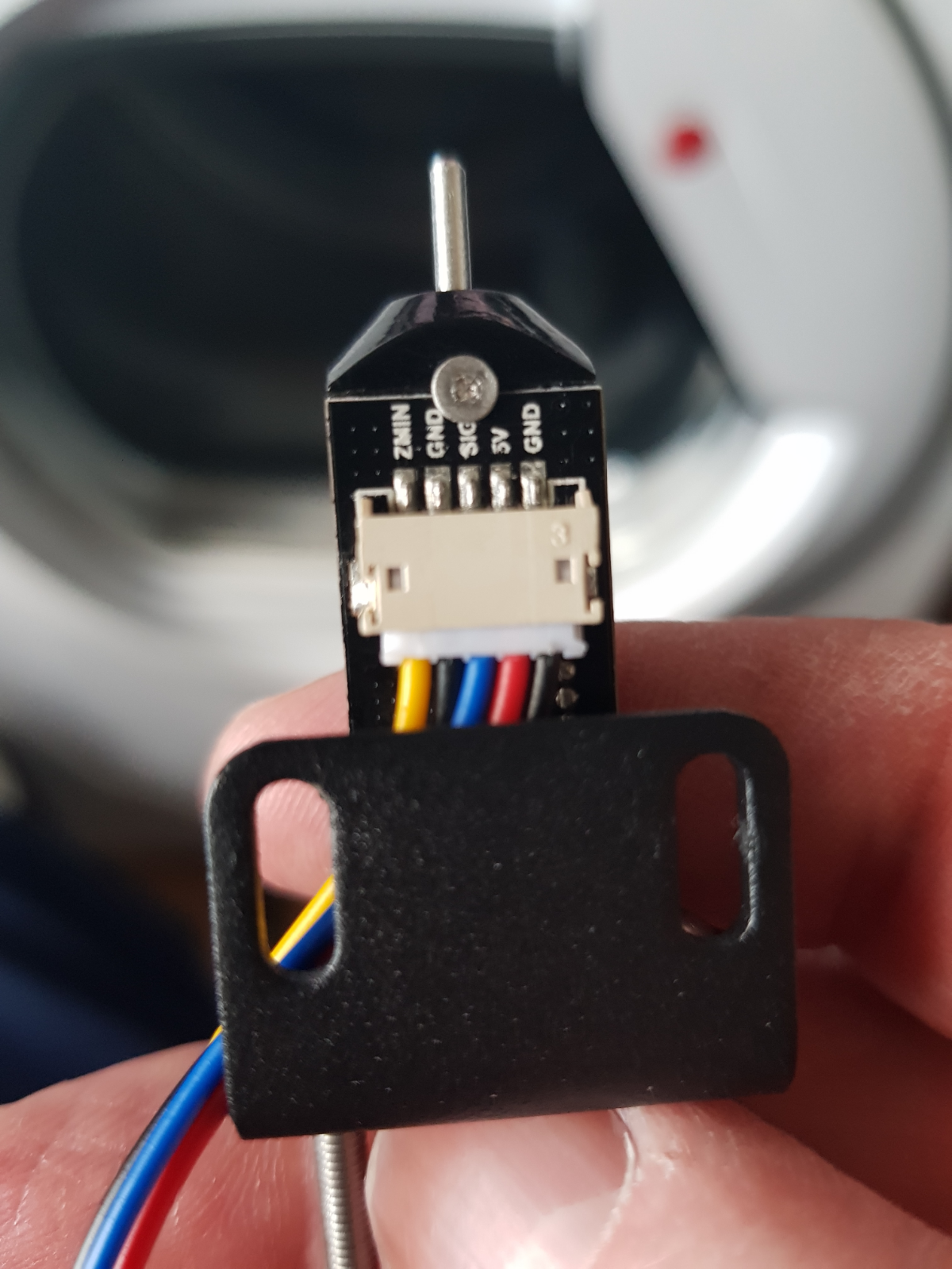

Can anyone help me, I have a Geeetech A10M and want to install a 3d touch sensor but it's not a original BLTouch.
I am very capable of installing it but it's the color of the wires I need to know where they go, as with the BLTouch it's easy but with the sensor I have it has different color wires. They are....... Black = GND Red = 3V Blue = SIG The other set of 2 wires are Black = GND Yellow = ZMIN.
So if anyone knows if the order of which is correct.

My Color wires are different to the video, I have red,blue,yellow and yellow and black.

Image of my sensor wire colors.

Hey Vert,
Thank You for your help and advice, It all helped me and the touch sensor is powering up and working fine after cross referencing the wire colors to the BLT touch image you referenced :).
Thanks again for your Fast Replies and patience :D.
