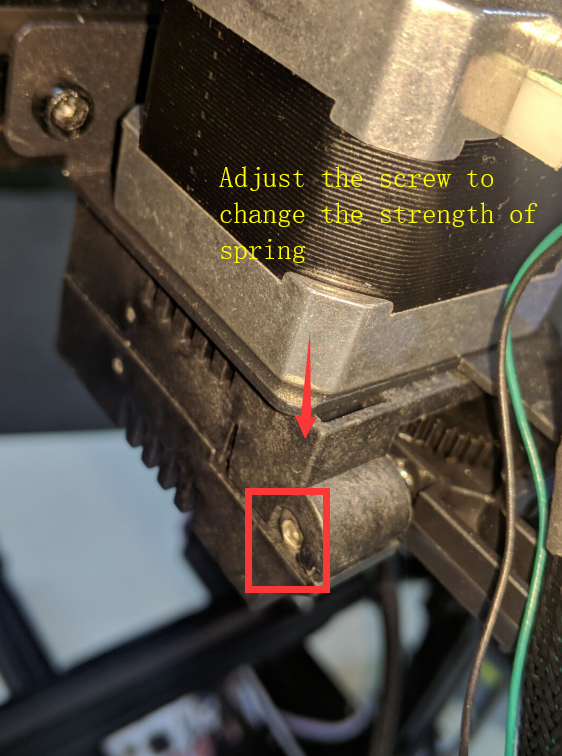

I think you should tight the feeder screw at first.
You can refer to the FAQ post then adjust it.(See the pin-up post of A10 section)

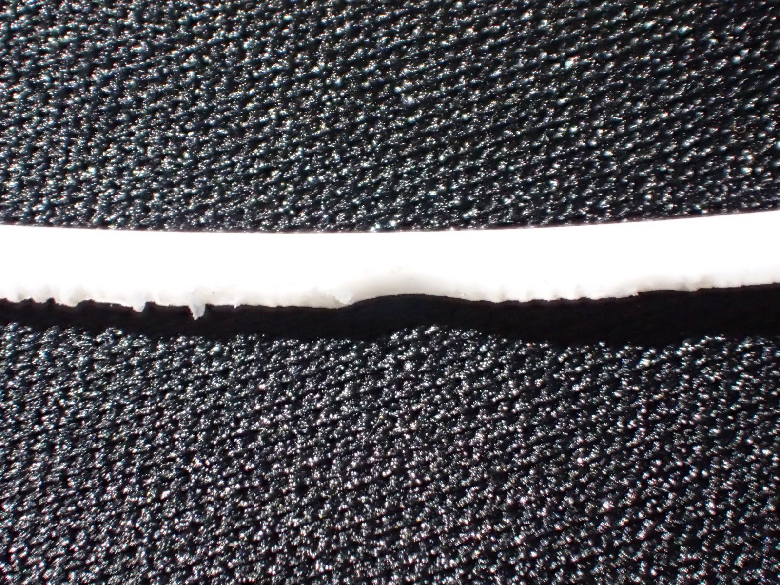

I have a similar problem with my new A10M and the second feeder (E1).
The filament seems to stuck sometimes, you can hear some clicking noises than.
The gear rasps some notches into the filament and won't be pushed into any further.
The other feeder works without any problems. Sometimes I notice some squeak from the first feeder.

I think you can refer to this pic then adjust the feeder spring
