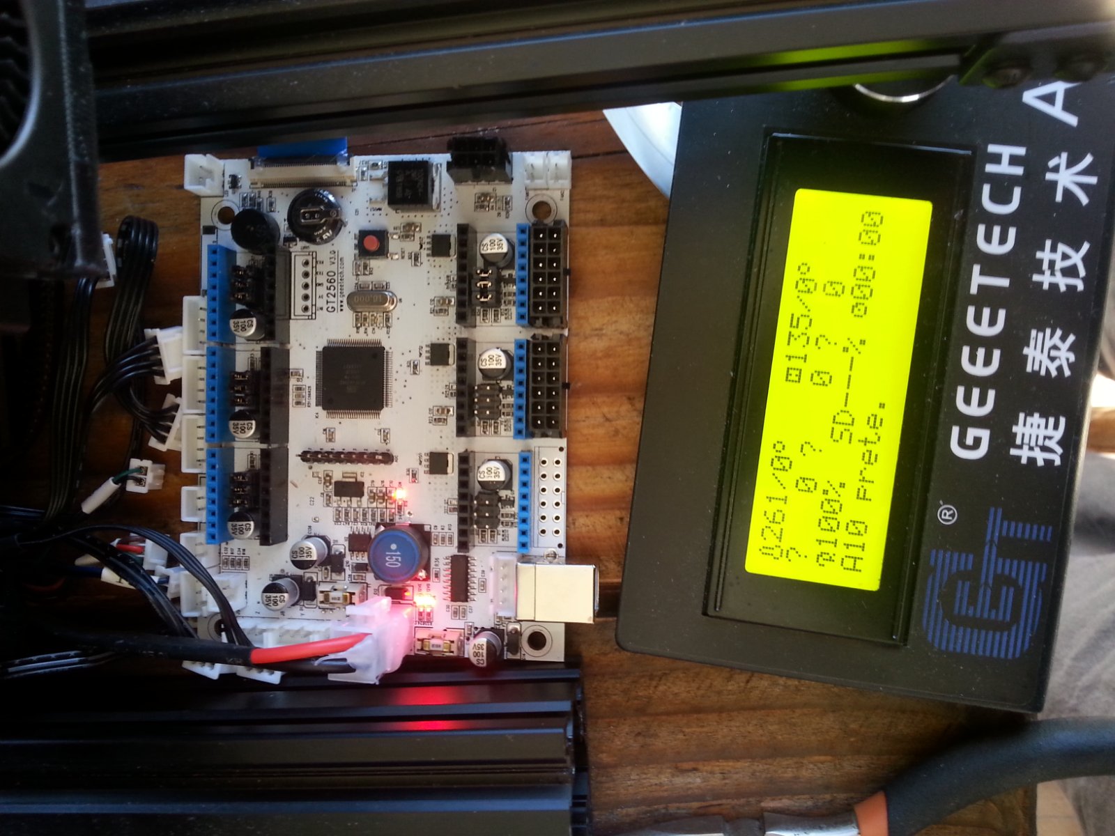

I tried by unplugging everything from the motherboard and flaming the firmware.
Always the same problem. view the photo

I am having the exact same issue. I also read that if disconnecting the leads doesn't change the issue that there is a short in the mobo, anyone know how to diagnose this?

It was not a problem of sensor or connection but a problem of motherboard. I changed the motherboard and everything is in order. With the same sensors and even connections.
Problem solved.
