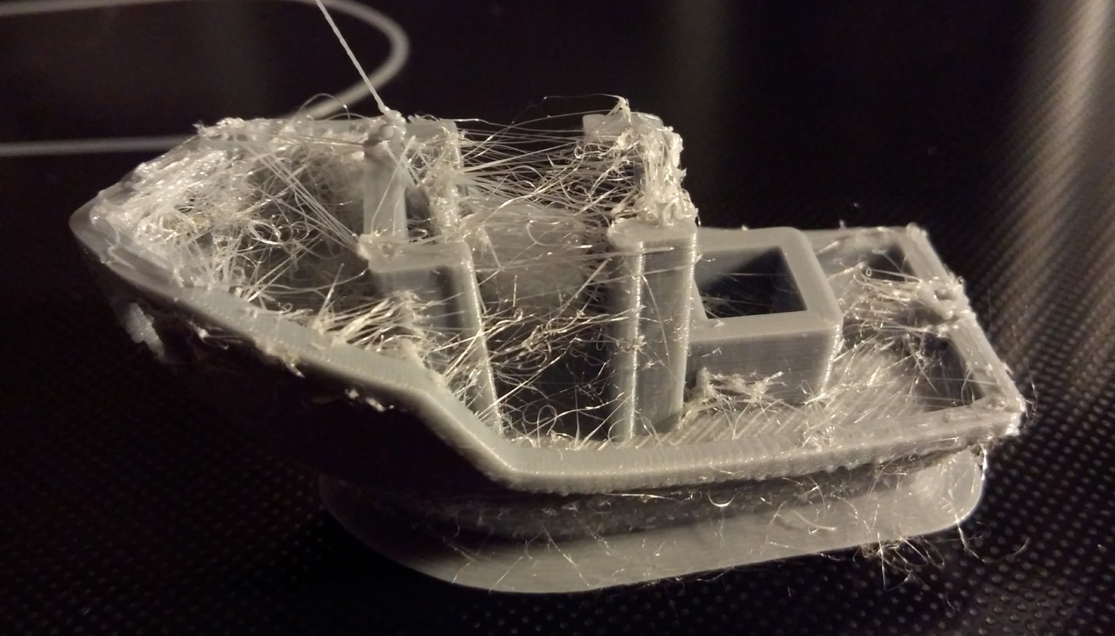

Hello all,
I have still massive problems with stringing:
I reduced / increased retraction, no success. I modified temperature, E-Steps/mm, Filament, ...
Now, the next I will try is to increase the print speed and to use Cura to enable Coasting, which isn't supported by Slic3r.
Any ideas?
Or, can somebody provide an gcode of the Benchy or any other sample which works well on his A20m?
Thanks,
Moritz

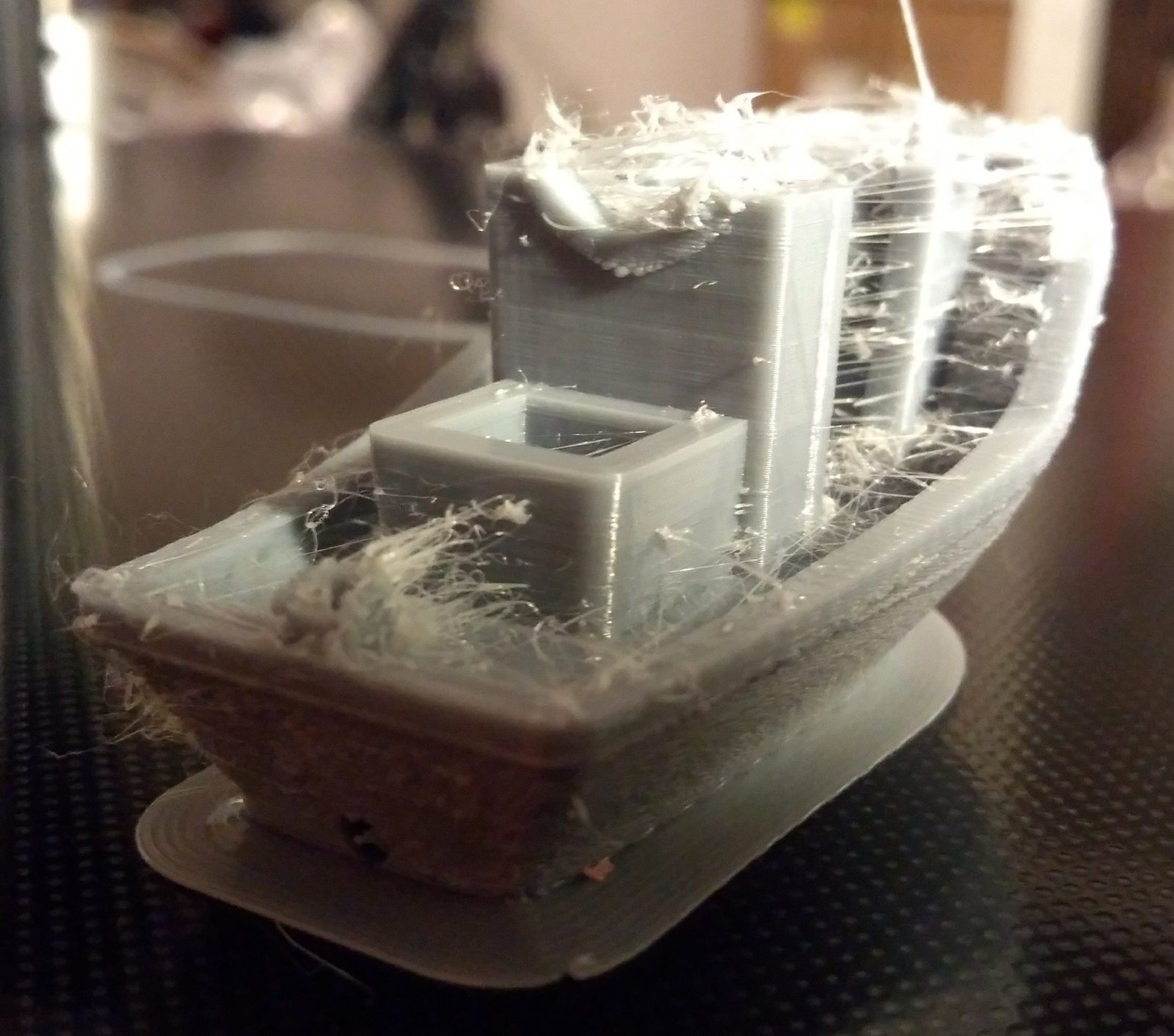

I increased the print speed, activated wipe and reduced the E-Steps/mm. Now, it is a bit better but still not comparable to what I get with my i3 Pro C.
I will now test Cura which supports Coasting, it may be a good alternative to retractiong, which doesn't work so good with the color mixing hot end.
Moritz
Moritz

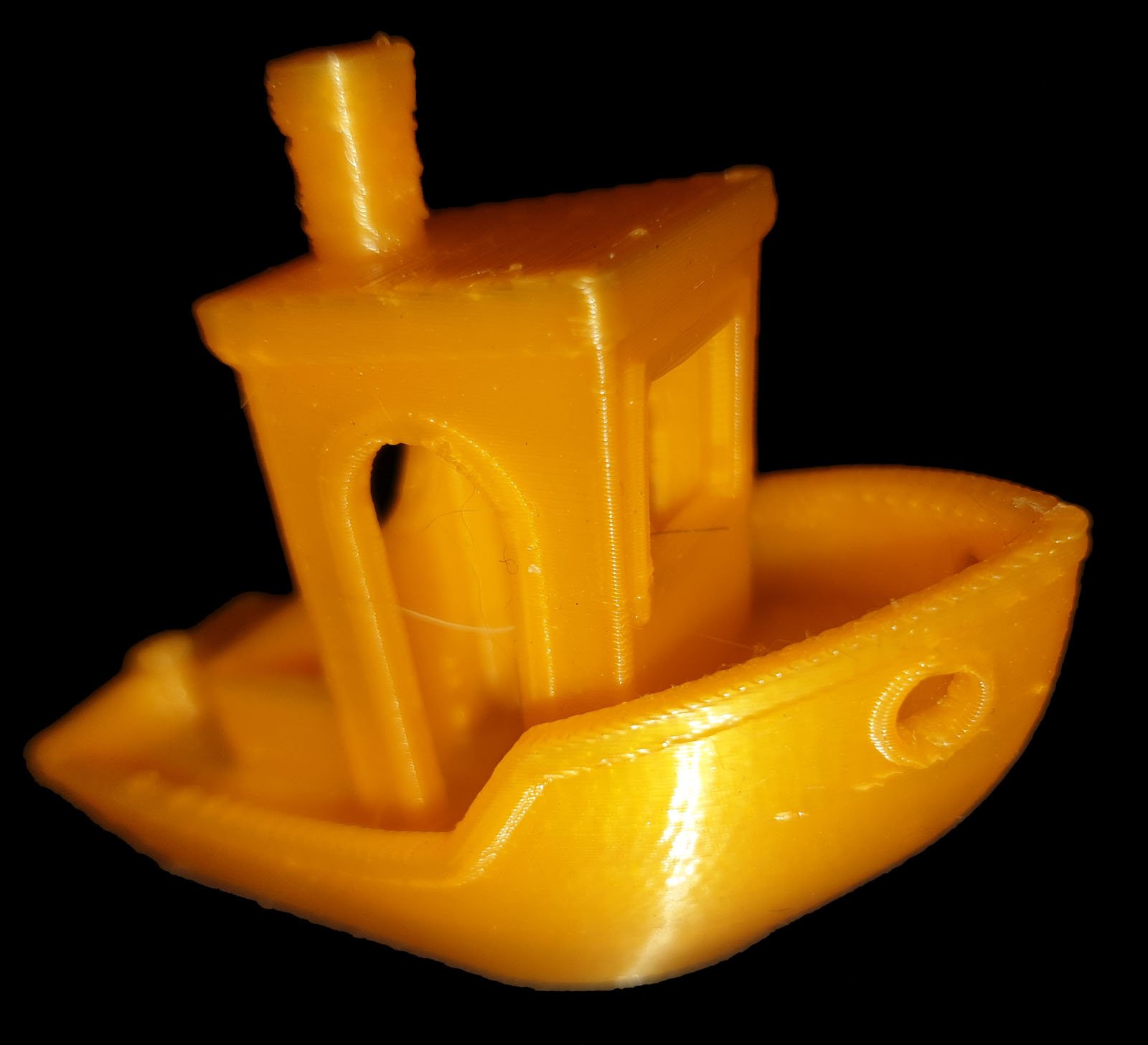

That is what I call massive stringing !
Here is a picture of a benchy printed with A20m stock with valve probably, dont know(only stepper drivers of X,Y,Z have been replaced by TMC2208 but I am sure that can not modify stringing), I try to join the gcode but I can only attach picture to the post..., I will try by PM.
Settings I remember : (but that shouldn't help a lot, you probably have a mechanical issue)
- layer height : 0.2
- print width : 0.4
- perimeters : 3
- main speed 50mm/s
- outline speed 37.5mm/s
- retractation 5mm at 30mm/s
Some ideas :
- wet filament ? https://www.youtube.com/watch?v=FAXUjZZER5E
- too fast retraction or extruder untight , that could make the filament slip when retracting
- temperature too hot
- cooling fan breaked
NB: stringing is not the only problem you have, some of your surfaces show a lot of rugosity

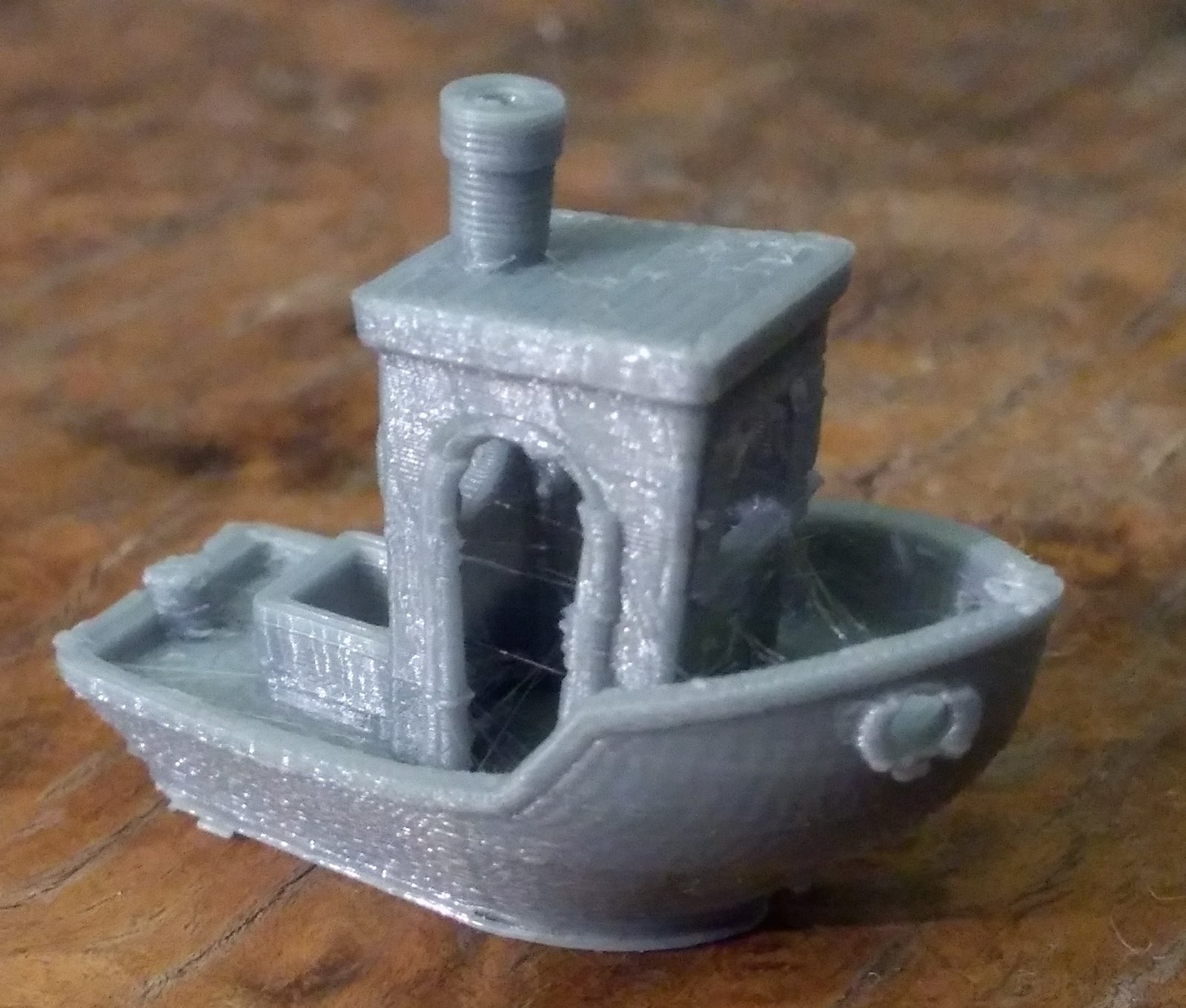

I removed the balls, tried all i can do on Cura. Single color prints are really nice, better than my ED3 Pro, but Dual Color look like tihs

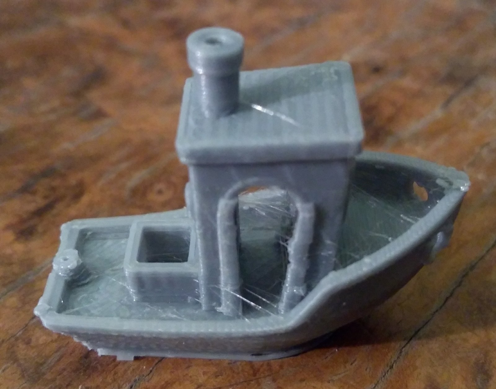

This print :
distance : 4
Speed : 40
I think i will try to re-install the balls
distance : 4
Speed : 40
