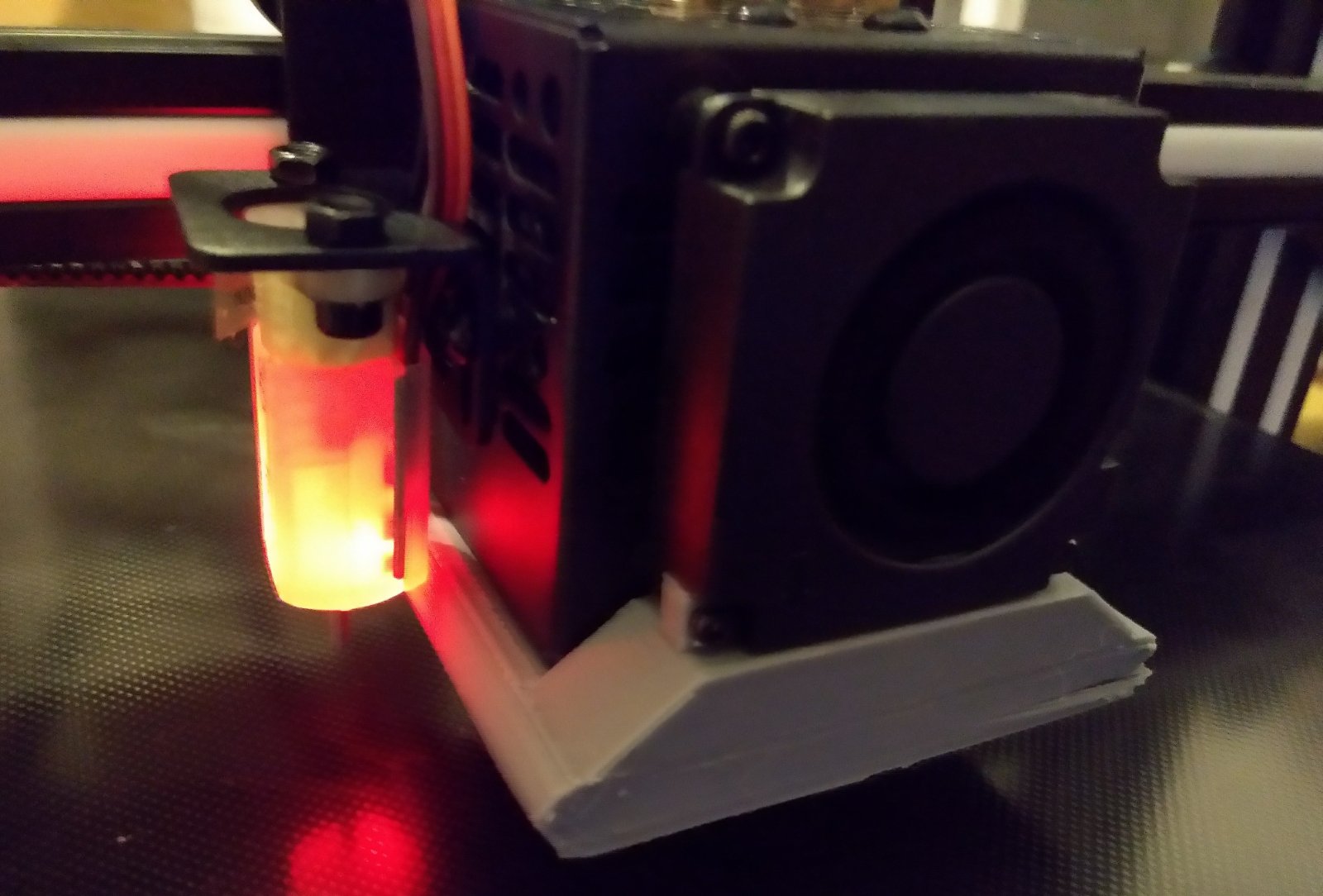

I am unable to calibrate my Z-axis
Every time I enter Gcode G1 Z0 it pushes the nozzle into the glass. And the when I enter M851 Zxxx, the Z offset on the LCD display is still the old one from before I swapped out hotends. I can't change it even though EEPROM is enabled.
This is a new hotend with a slightly longer neck than the old one. So I can see why it's doing this if it's using the old Z offset. Buy WHY is it still using the old Z offset?
When I calibrated my original hotend, the process worked perfectly. It took some trial and error, but I could actually change the numbers using the LCD menu and Repetier. This time it won't change.
Any suggestions?
