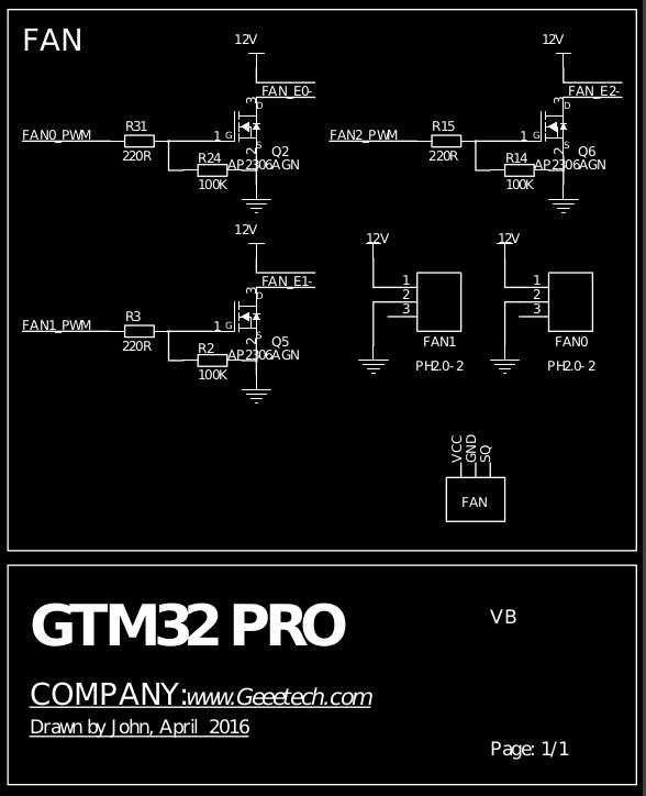

ad2. Here we have different possibilities.
We already know that there is a special version of the fan designed for rotational speed control.
Now I will describe the possibilities we have for the other types.
To influence the fan speed, limit the current supply.
  • The simplest way is to connect a resistor to one of the power supply leads. This is not the best and recommended method. It has its drawbacks.
  • A better solution is to introduce the PWM signal to one of the power supply leads. This is the solution used by the manufacturer of our printers for selected fans. If you are interested in the method of action, please refer to wiki.
In this case, if the fan has a yellow cable, it is not used. This lead is floating in the open.
