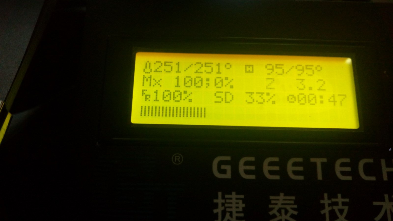

Apparently also have weird printing results after "missing" Z-ES wire resolved.
Remixed projects with slic3r software for 1/3 speed recommended 10mm/s iso 30mm/s.
So far, leveling done many times but prints cannot rise above 1 mm from hotbed despite Z "shown" 3.2mm.
SD Print .33.jpg (105.12 KiB) Viewed 11394 times

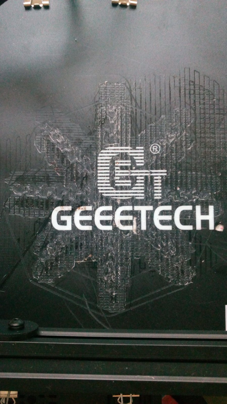

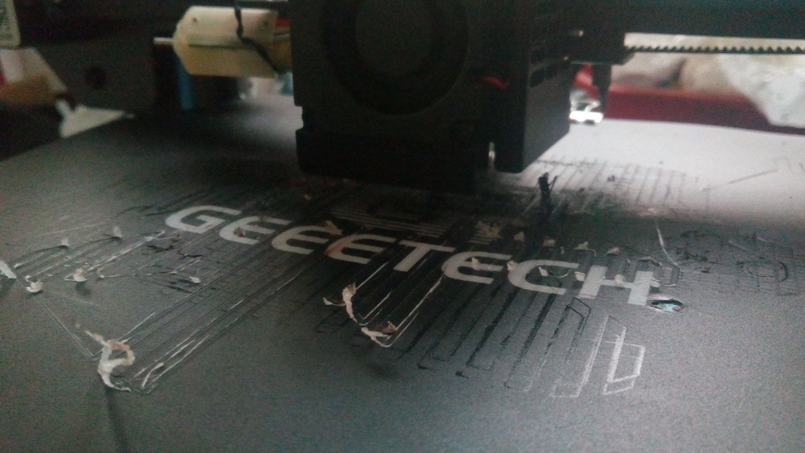

Even after "octopus" ended after 2 hr 34 mins, just have white nylon
imprint on hotbed despite screen showing Z at 38.4 mm.
Octopus Start.jpg (207.57 KiB) Viewed 11394 times
EEPROM reset, able to "auto-home" then raised Z to 150 mm few times after print started.
White Nylon.jpg (147.13 KiB) Viewed 11394 times

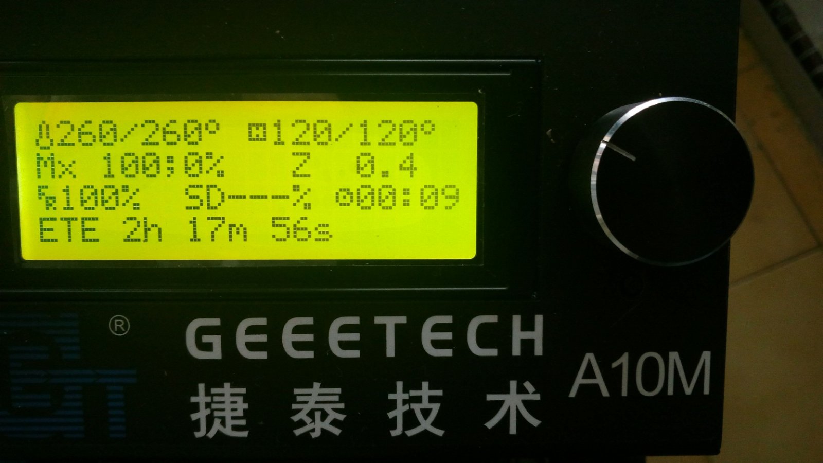

by leongy1717
Not using PLA filament all the while. Have been talking about Nylon PA66 filament for days.
The issues are printing even at 10 mm/s and either black or white Nylon filament (each oozing from extruder at 260 deg C)
ONLY can get 2D print even after 2 hours 25 minutes printing of mini Octopus. On green LCD screen was showing 38.4 mm
but only 2D output, i.e. extruder cannot rise above 1 mm on Z-axis.
Manually can shift Z-axis cum extruder on "Prepare" sub-menu to above 200 mm.
"Auto-Home" many times no problem for many levelling with A4 paper friction test at 4 corners done.
