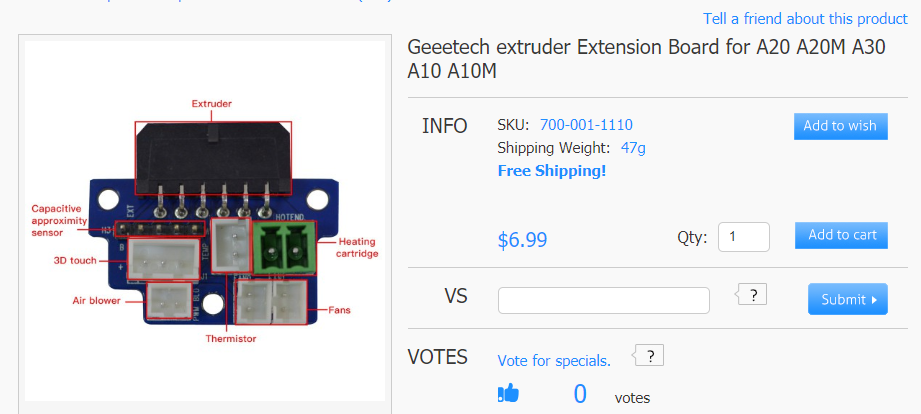

:shock: maybe you refer to this:
It's for A10/A20series.

This is the board I have, I've connected it up this way and it doesn't respond to test codes, I assume this is because the pin is different do you know the pin number, or would you advise to use the top header only
