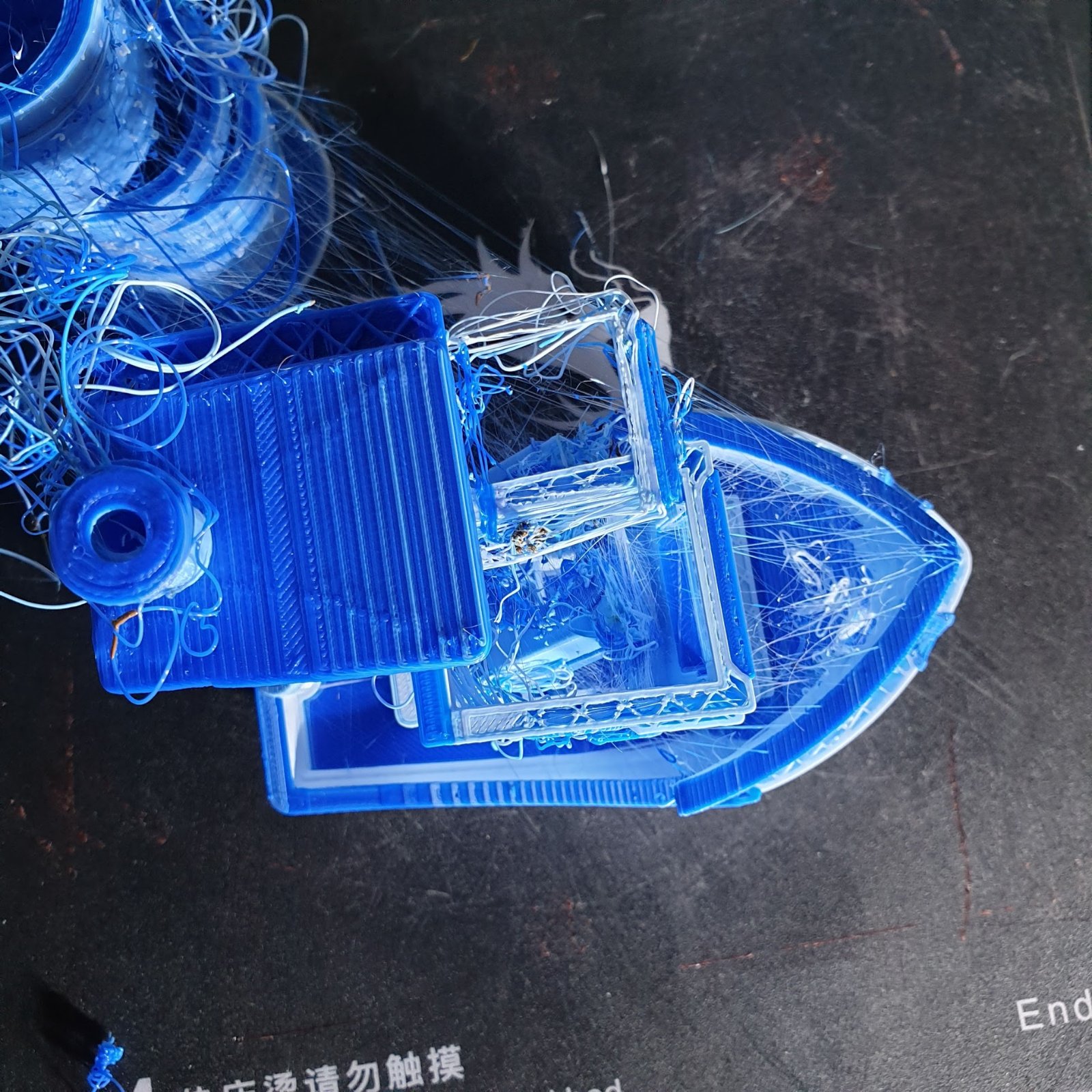

Here's an example of the last print I attempted:
It's a 200% scale Benchy printed in two colours, and there are no fewer that 7 layer shifts in this print!

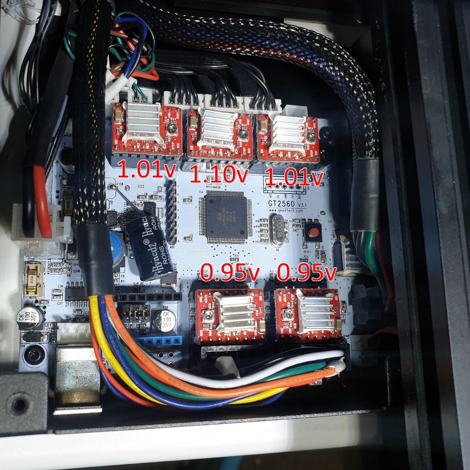

I have tried tensioning both the X and Y axis belts. If anything the Y-axis belt was in fact too tight and after loosening it a little there were fewer shifts but they still occur. Another issue I noticed was that one of the wheels on the X-axis was not turning when the carriage slid across and there was significant 'slop' in the carriage assembly itself. By tensioning the underside wheel I was able to bring this wheel into contact with the guide rail and remove the 'slop' in the carriage but it induced a significant number of X-axis ships when printing. I have also checked the 5 stepper voltages and they came up as 0.95V, 0.95V, 1.01V, 1.10V and 1.01V. I believe these represent the E1, E0, Z-axis, Y-axis and X-axis respectively:

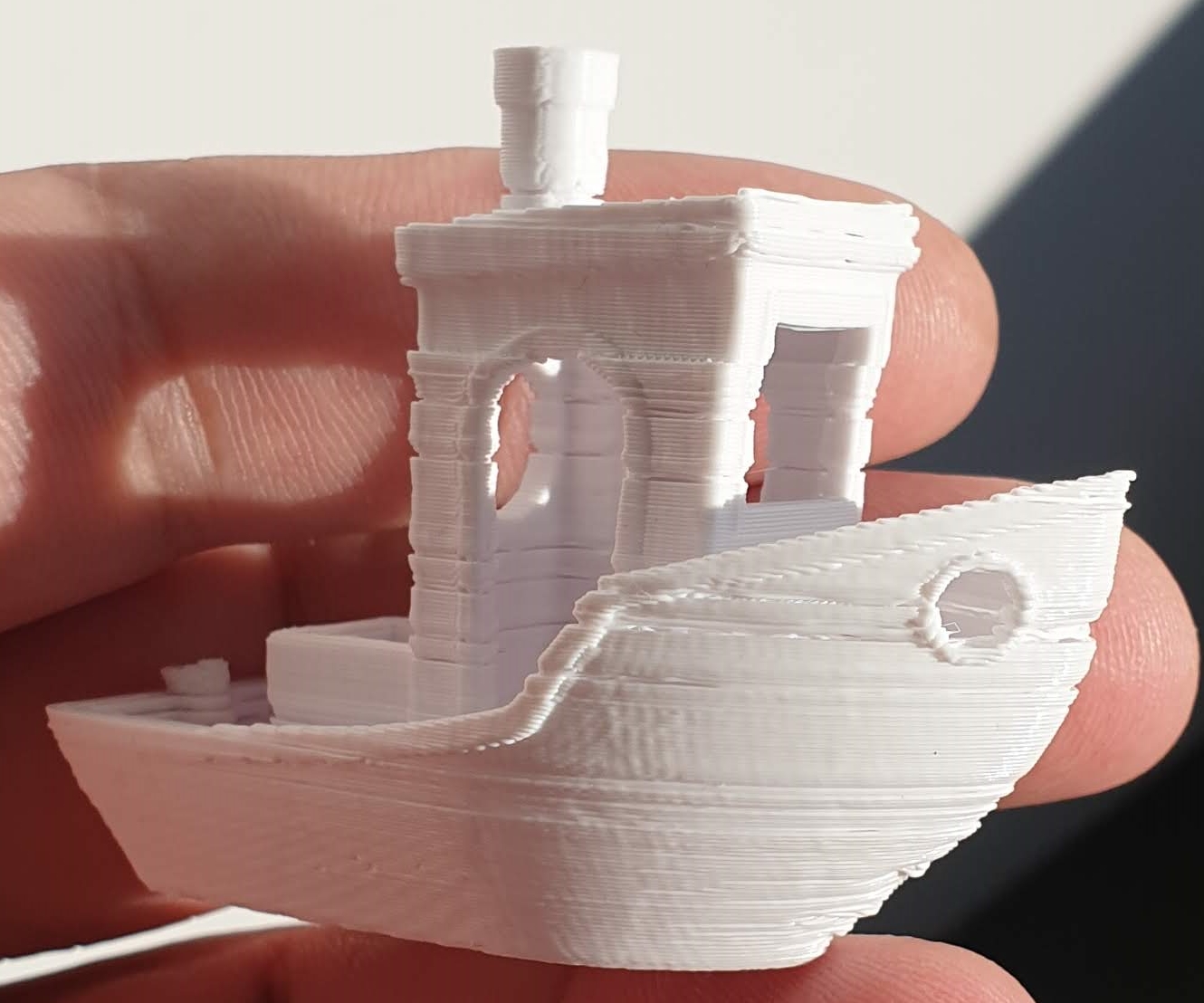

This is how the last print came out:
Note there are multiple shifts in both axis with the y axis shifting on both directions.

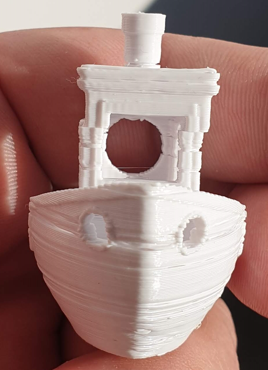

Also, it's probably worth pointing out that even when the printer is essentially working it still produces exceedingly poor prints:
Note, there is a slight y-shift in this print as well toward the top:
Strangely though the print seems a lot smoother after the shift than it does before. No idea why.

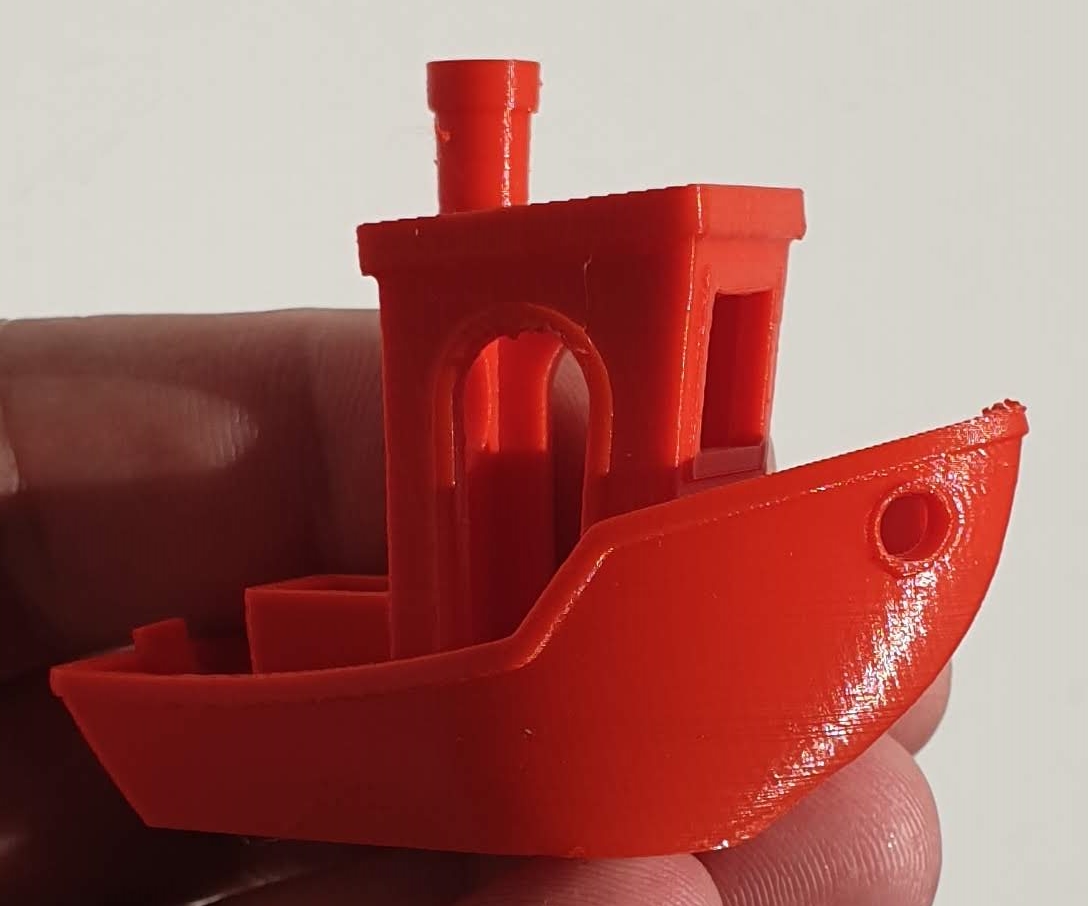

And finally, for comparison, here is a print from my Ender-3 (which my A10M was intended to replace):
The difference is like night and day!
