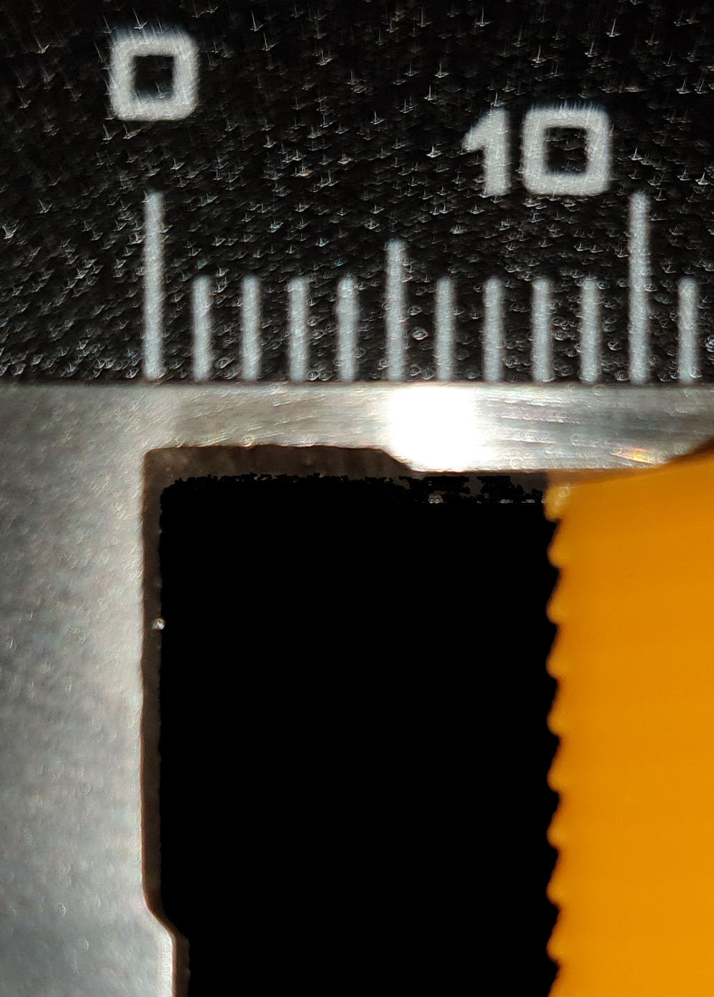

On the A20m I got non planar wall, look like mini stairs (see pictures), specialy on cube border along z axis, this is a very small default but I have not this problem with my other printer.
Those mini stairs are constant along z axis on the whole height.
Any idea ?

the right side of X axis is too tight. And left side at Z screw possibly not tighten well.
Top side seems over extruded

thanks, so I should try to lose a little right X axis wheels ? I start a new print with this modification to see if it help.
The top layer is fine, probably the photo give this impression of over extrusion but it's really nice in reality.

I tight the left x axis wheel and lose the right one but unfortunatly no change :(, result is the same, little stairs are still there, do you think I should try to tight it even more ? NB: they appear in all the fourth borders along z axis.
I noticed that the default A20m profile on Simplify3D set the jerk to 10, I will try with 9 and see if it help.

Also I am wondering if it is not related to retractation because stair seems to be 4 layer height and retractation occur on each corner every 4 layers (according to simplify 3d preview), first layer it retract on border 1, 2nd layer it retract on border 2 etc...
Also in vase mode the stairs completly disapear.

Some more tests results :
- Trying with the second extruder (a20m) and a different filament doesn't help, same issue.
- Disabling retractation doesn't help
It is maybe something related to slicing (Simplify3D) because I notice that the nozzle go twice at the same location exacly every 4 layers, and stair's are every 4 layers.
I mean there is maybe something wrong on the slicing, because it go on the outer perimeter, draw it, than get back at the same location it started rather than a bit before, so the nozzle print twice at the location it started the outer perimeter.

I really think that this problem may come from the path of the nozzle when using infill. I will investigate more on the generated gcode to see if I am right or wrong. Maybe I missed an option in the slicer but I have done so many tests.
For now here are some results :
Those tests have been performed on two printers a20m, cr10s pro, three differents extruders, three différents filaments, two nozzles 0.4 and 0.6, one slicer Simplify3d.
Layers height : 0.3
Vase mode => render is ok
Two outline + infill 15% overlap infill 15% => render stairs on corner
Two outline + infill 15% overlap infill 0% => render stairs on corner
Two outline + infill 3% overlap infill 15% => render stairs on corner
Two outline + infill 1% overlap infill 15% => RENDER IS ok ! ( I really cant explain this result )
One outline no infill => render is ok
Two outline no infill => render is ok
N outline no infill => render is ok
NB: with layer of 0.1mm all print are ok, with or without infill, at least my vision is not enought accurate to see them...
It is a very small defect, less than half a millimeter, that appear with layers of 0.3mm height, nearly invisible with lower layers height.
