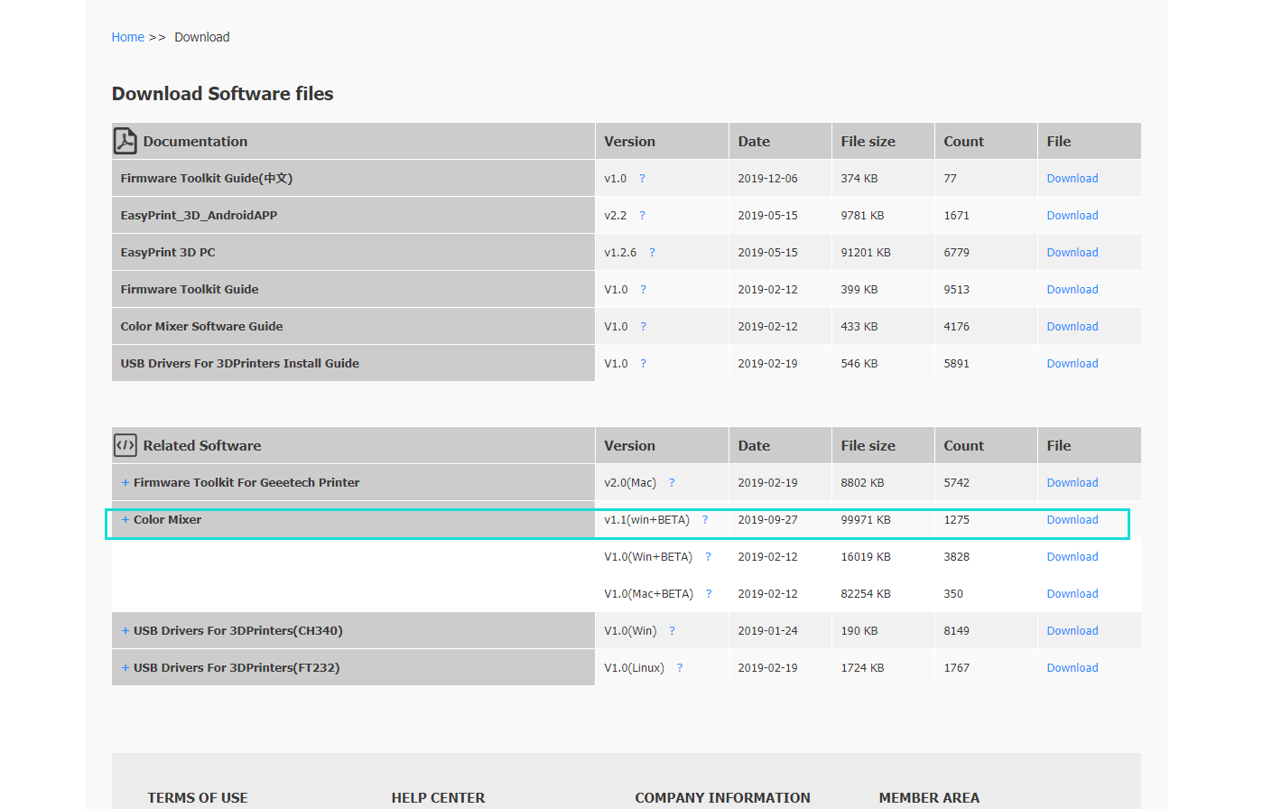

Geeeko wrote: Sun Dec 08, 2019 12:16 pm I received my A10T today and the Cura profile comes just in time, great ! :)
Request : please Geeetech, consider providing a plugin like 'colormix 2-1' plugin for Cura but using the 3 extruders (colormix handle only 2 extruders).
Question : Is there is a way to avoid that the heating head stay still for several seconds (waiting a temperature change even if there is no such change in the settings) over the printed object when switching to the next color/extruder ?
This creates 'blobs' of PLA that could ruin a print. Maybe there is a script possible that can move the head over the prime tower instead of waiting over the object ?
Hi, You can download the new version of color mix on the official website: https://www.geeetech.com/download.html?download_id=40
You can refer to this: viewtopic.php?f=92&t=69600

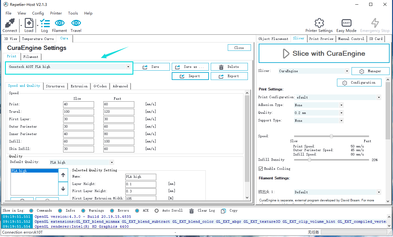

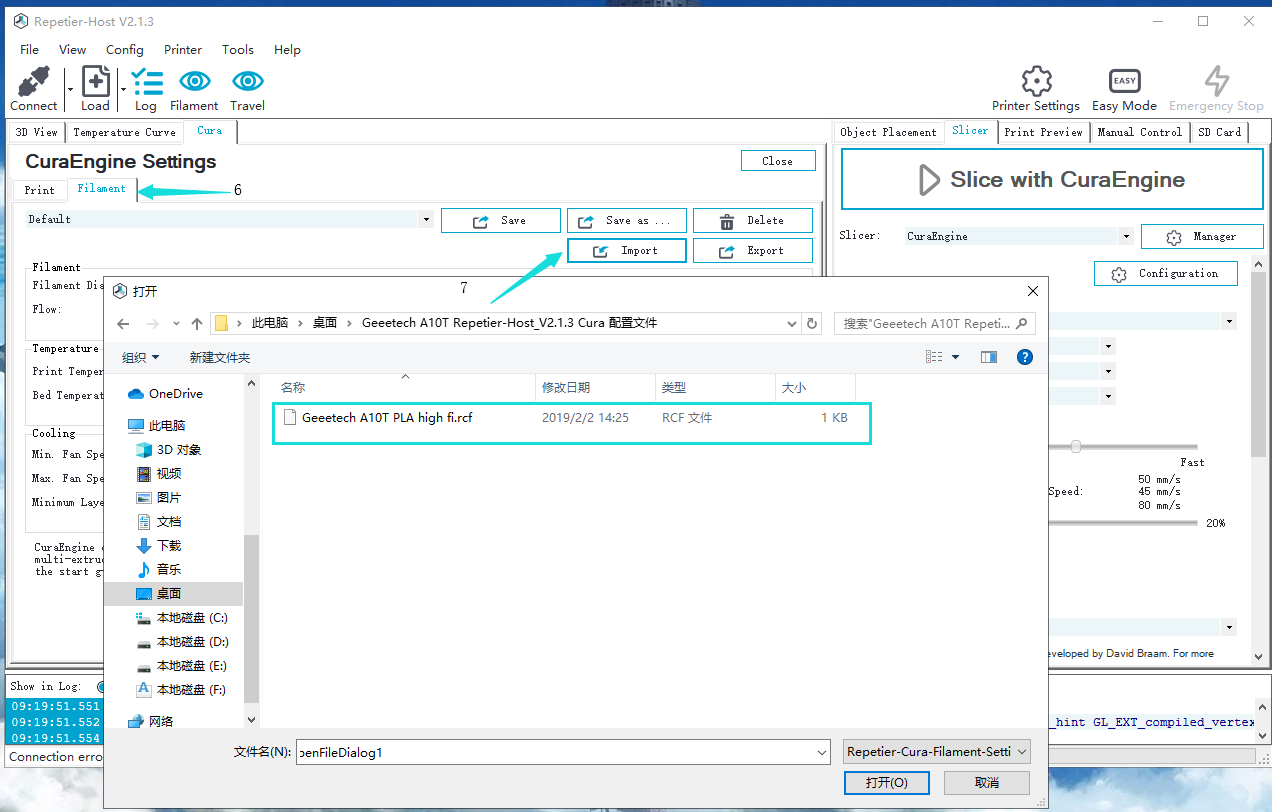

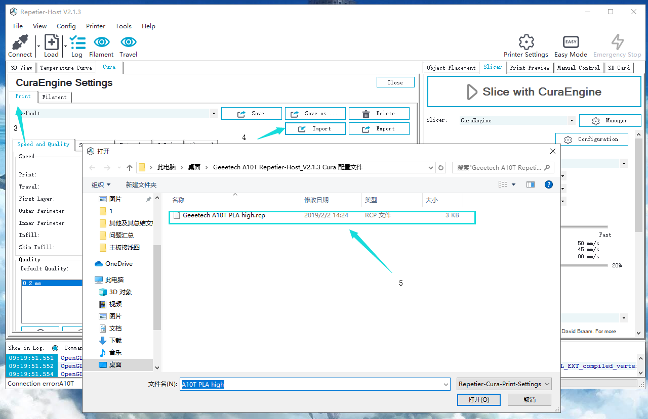

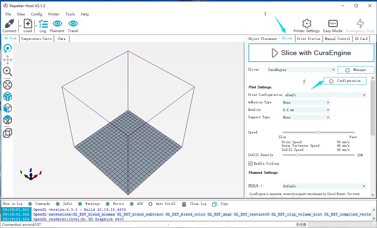

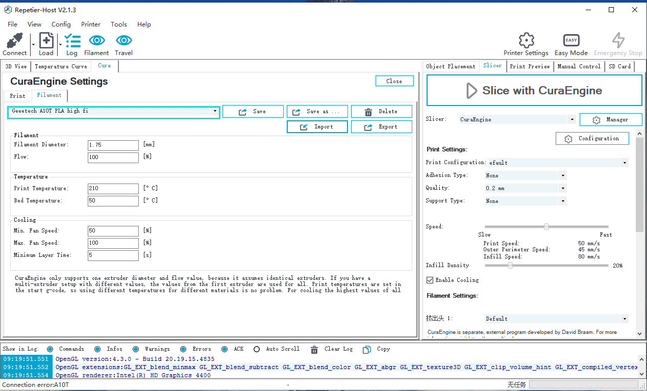

I downloaded the Repetier-Host file but I don't know what to do with it. It came with two files. Do I have to drop them in a certain folder? I tried to find a way to import them but I didn't see that.
Thank You!

Hi,I will explain to you through the picture.
I hope this can help you.
