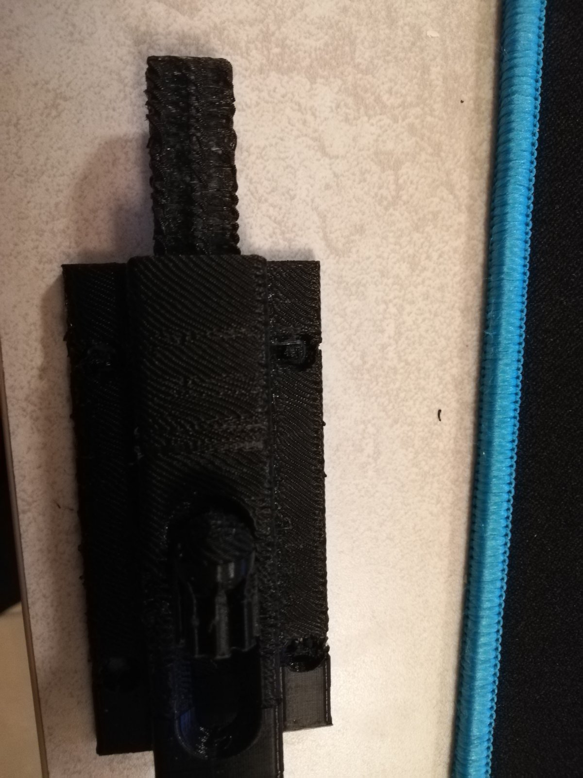

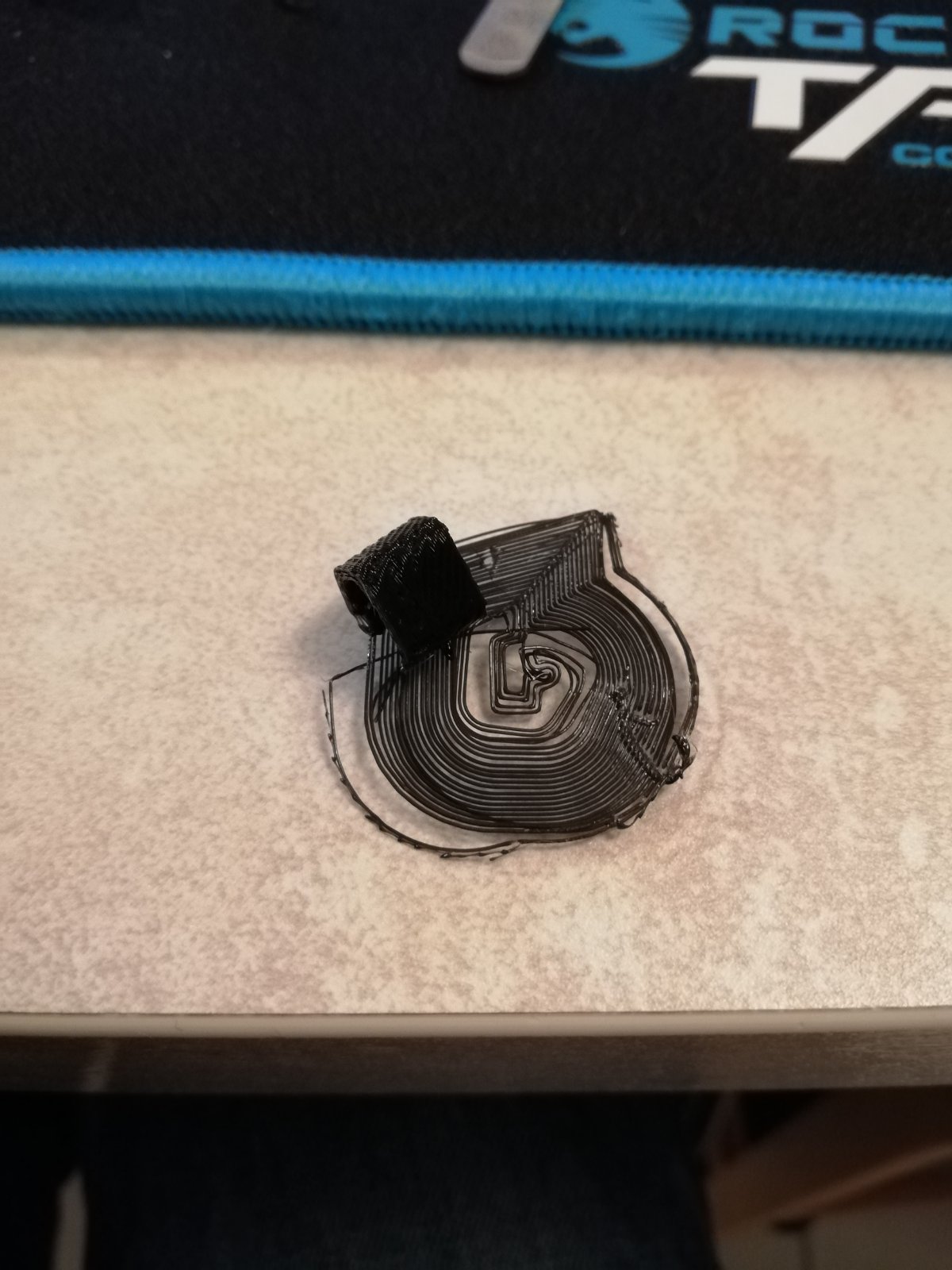

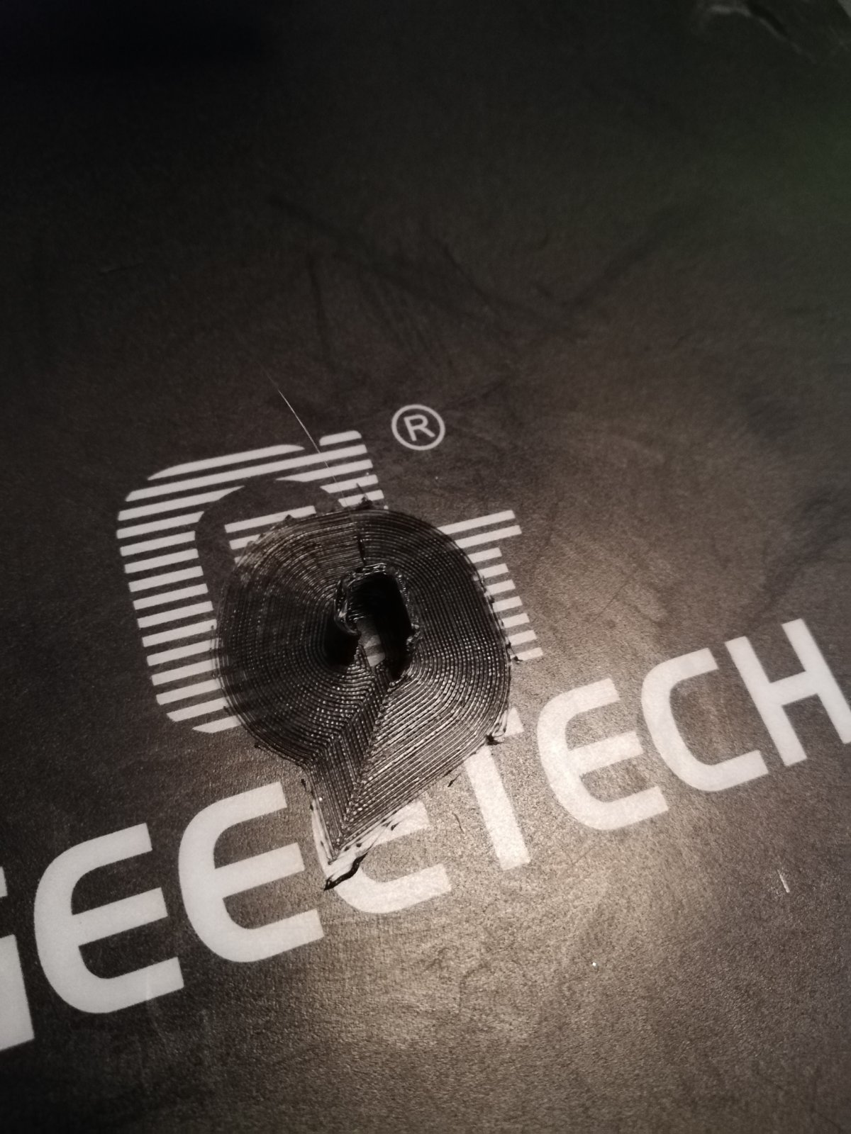

I am new to 3D printing despite the help of a connoisseur and tutorials I can not find a solution ... the brim is not a plate but filaments that stick almost between them.
Then in the rooms we see a lot of holes, the layers are not compact.
I had my printer A10 last Friday, received badly and a lot of play in the paten but she printed the evening. The next day after the adjustments it always makes me the same problem and I seek for 6 days I try different leveling of the bed, different speeds, thicknesses, repetier profile host. please help me (the plateau is not super plan). (sorry for the mistakes it's google translation)

Hi, You can try to level the hot bed again,
Printing speed reference range: 30-60mm / s
Jarda3d
Posts: 189
Joined: Sat Jan 26, 2019 8:42 am
Re: printing problem A10
Post by Jarda3d »
Bed leveling should do in "hot state". So preheat it for about 15 mins together with extruder adn then do bed leveling.
Calibrate extruder steps
Try it again
A10 Slic3r profile: here
