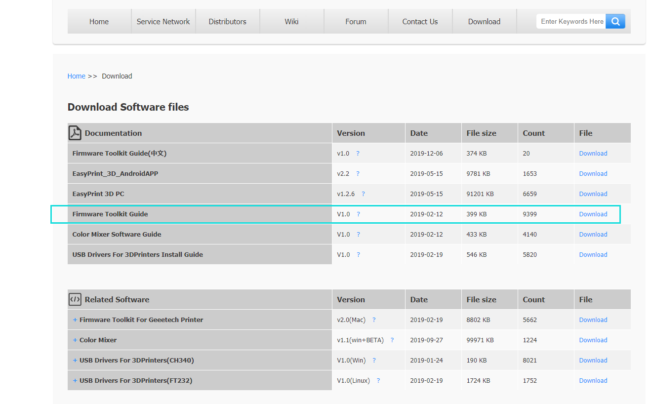

Hi, Regarding hex format firmware,
You can refresh it using the tool: https://www.geeetech.com/download.html?download_id=40
You can refer to this:

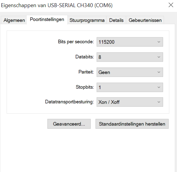

by andrevanderweide
put the compoort on 115200
start toolkit load the hex file
start programming
push reset a20t
and there it start programming
Grt André
